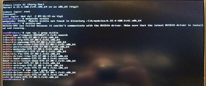

This has to be a BIOS settings issue. You need to ensure your NVIDIA GPU is set as the primary.
Yeah, please check.
Yeah, I did check the BIOS, and I didn’t find many items related to the graphics card.
And before installing Ubuntu, the graphics card was running on Windows 11 with the same settings, so I’m not sure this is the issue.
It seems like I’ve worked enough with the current motherboard, so probably it’s time to try with another brand’s board.
Thank you all for your dedicated help! =))
I’ve never seen anything like this problem. Hope you get it fixed, especially after all the effort you’ve put in!
ASUS and ASRock should be fine. My i9-14900K is running on this miniITX board. With 64 GB of DDR5-6400 CL32 from G.Skill. (280mm BeQuiet AIO cooler, which is not enough to keep it from thermal throttling in some cases)
GPU is RTX A4500.
Just noticed you’re using version 575.57.08 on kernel 6.15.4. It’s incompatible. I use official version 570.169 on kernel 6.15.4 with no problems.
Damn! So, that may be the reason.
May I ask how to install 570.169?
Thanks, Jussi!
I’m considering ASRock Z790 Steel Legend WiFi.
The one you’re using is no longer available where I live.
After trying what Chunhao suggested, I’ll try the ASRock if it doesn’t work.
I’m an old school guy. I don’t like to use in-tree distro’s dkms module. I always download the driver from nvidia website directly:
Build it locally. Before you build the driver you have to blacklist the nouveau driver:

Then execute the nvidia driver installer:
sudo ./NVIDIA-Linux-x86_64-570.169.run
Thank you for the detailed procedure!
I’ll install Fedora once again and try it in the evening.
Oops I forgot you’re using Fedora. The above CLI needs to be changed to rpm-related commands and packages… sorry about that. :sweat_smile:

It would be hard for me to convert the commands to Fedora’s, so I’ll try it on Ubuntu Server and see if it works.

With the instructions I gave you get the official Nvidia’s driver straight from Nvidia’s CUDA package repository… This ensures it is up to date and compatible with CUDA.
Note that 570 is old version and will soon stop working with HQPlayer. Currently drivers are 575 series. Please also use the Nvidia’s new fully open source driver, not the legacy semi-binary one. This is Nvidia’s recommendation. The legacy one is becoming obsolete and will be discontinued.
I’ve just finished flashing Ubuntu 24.04.2 server (I overwrote the flash drive with the Desktop version), and I realized the kernel version would be different from what was displayed in the photo I took with Fedora 41.
I think I should purchase the ASRock motherboard and work on that one.
Thanks, though, :wink:
PS. And I’ve just ordered it!
Really hope it works this time.
