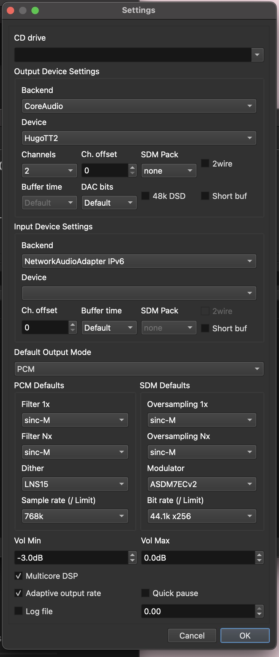

So I just downloaded the trial of HQPlayer and got it playing with Roon after tinkering.
Can someone take a look at my settings and let me know if these are the best settings to use that would be closest to the M Scaler with my TT2? Any suggestions would be appreciated:
Add images
sinc-Ll is technically closest to M Scaler as filter type. But you have better choices as well, such as the sinc-M you have selected. Or even better for example poly-sinc-gauss-xla. So also give other filters a try, you can use the table in manual to help choosing potential candidates.

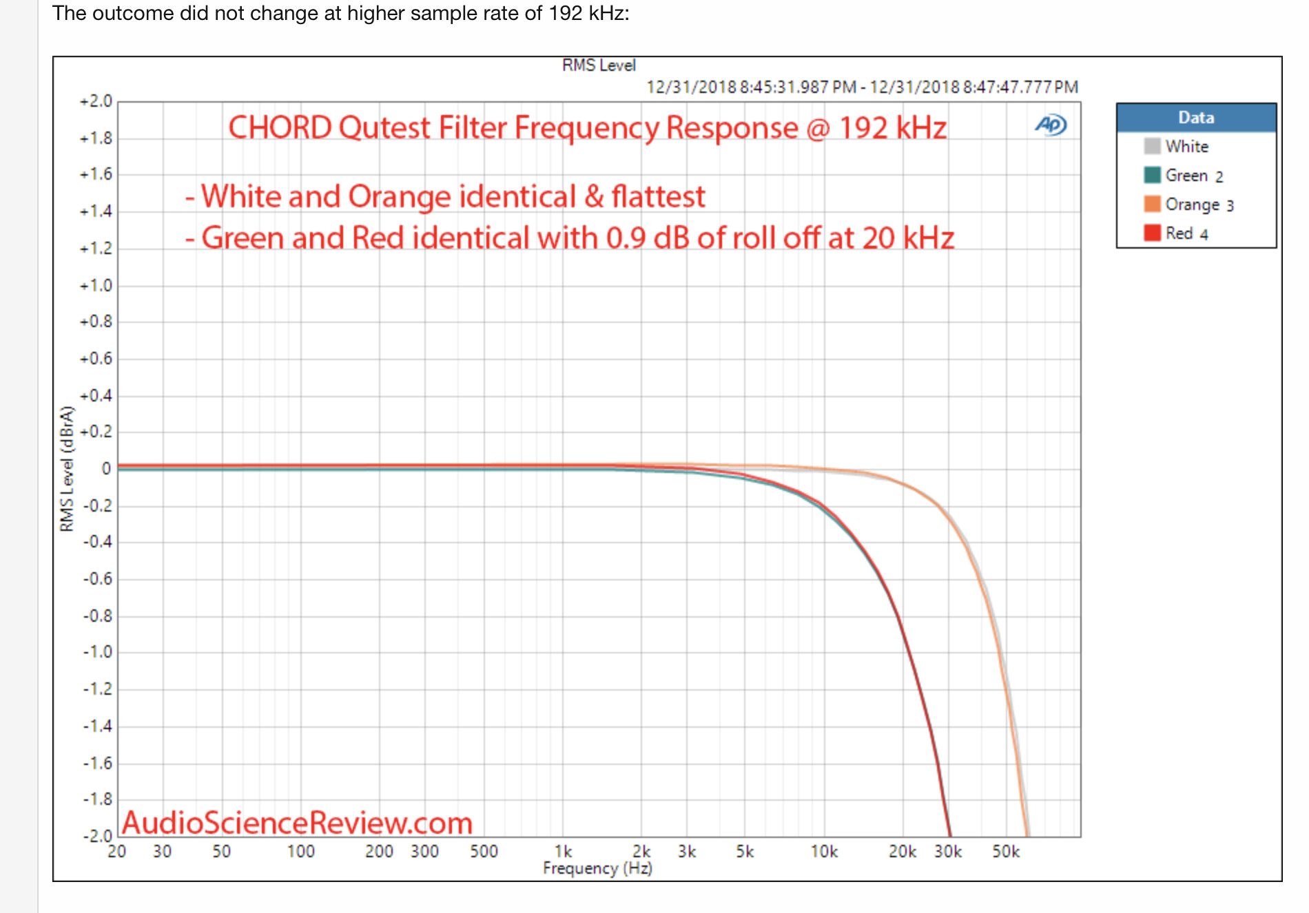

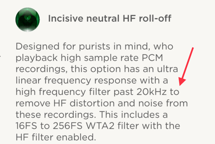

the Qutest and Hugo2 (and I’m assuming other Chord DACs) have the option to enable a “high frequency filter beyond 20kHz”. This seems very similar to the HQPlayer 20kHz filter option, which makes a lot of sense as a way to mitigate poor HiRes recordings.
When I am playing upsampled 16x PCM from HQPlayer, would you recommend leaving this “20kHz” filter in the Chord DAC turned on or off? For filtering high frequency noise from HiRes source material I am using the 20kHz filter in HQPlayer, so using both seems redundant. Thanks!
Where did you see this Chord description?
The user guide mention it (this is the Qutest user guide)

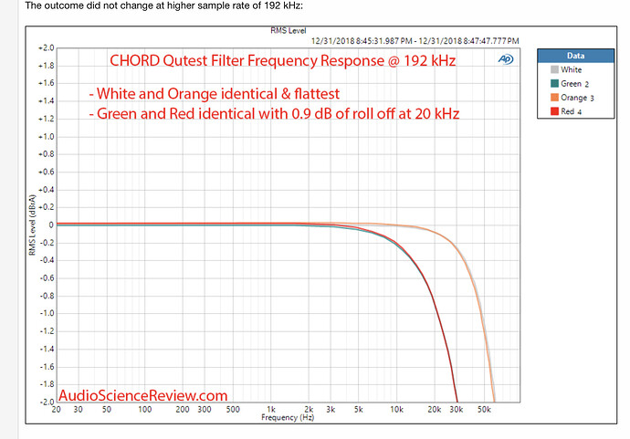

Measurements are more useful than their words. It looks to be a low pass filter, green filter similar in general concept to HQPlayers 20kHz filter. Although filter design obviously different (steepness, amount of fitlering etc)
Leave it off, it won’t improve anything.
@elementze have you worked out how to turn it off? I’m not sure what the best setting to turn it off is. It seems like by some use of logic when reading the four setting’s blurb in the manual it is best to use Red because it is the only one that is neither WTA1 or WTA2. Or if I’m sending 705/768 kHz is the filter disabled anyway?
Yes, first filter stage is bypassed when you input at such rates. This is also what MScaler does.
