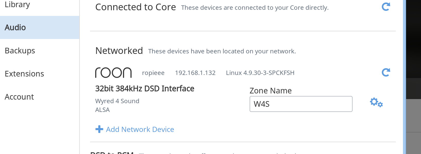

Yes. RoPieee is detected based on RoonBridge running. So it should look like this:
Hmmmm… I don’t think you do anything wrong tbh. This puzzles me.
