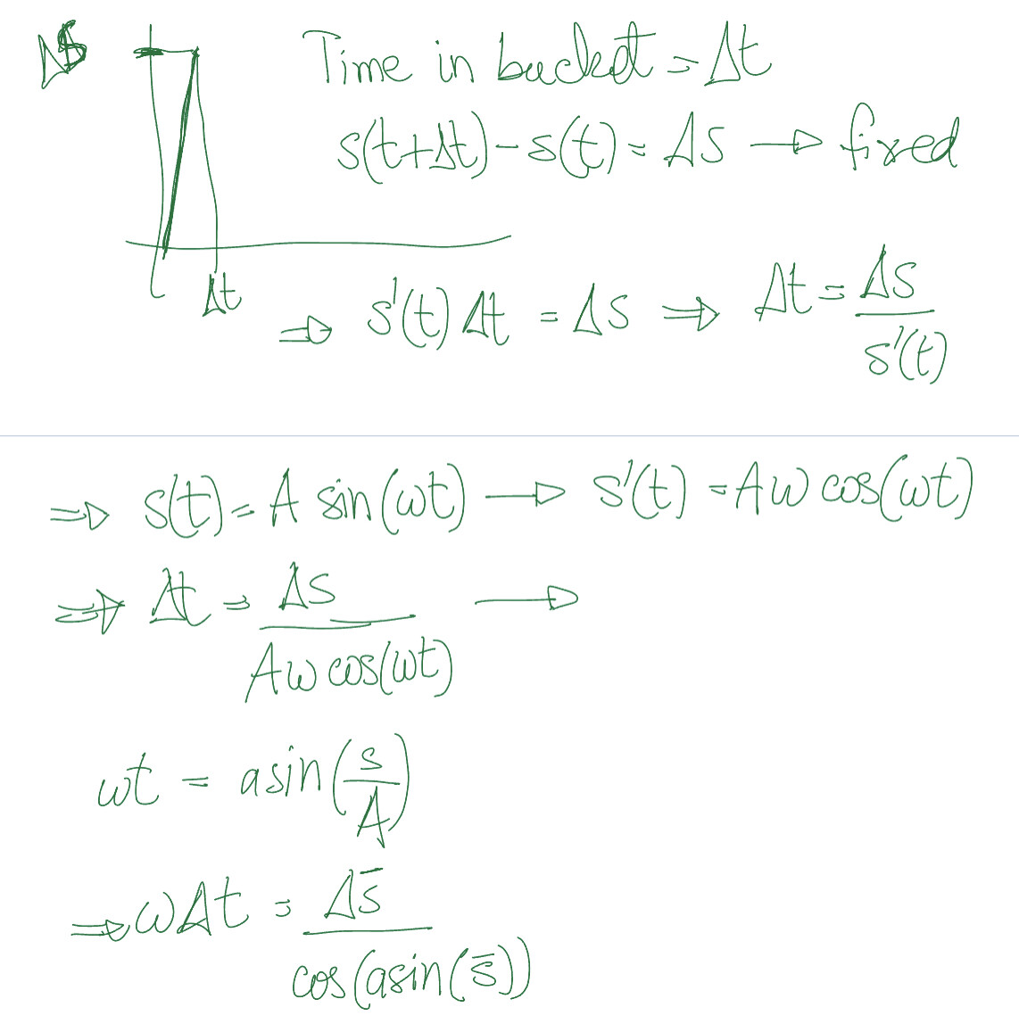

The horizontal coordinates are amplitudes, the vertical is a histogram in each amplitude bucket.
For a sine wave, the amount of time in a bucket ds is:
(this is the yellow line)
For music, it is like collapsing a waveform onto the signal axis:
and what you get is something like the red line.

(I assume s-bar is s/A)
Something is fishy here. First, if delta-s is fixed (i.e. finite), then delta-t can’t be approximated using the first derivative. If you do that, then any signal that has a local extreme at some moment in time (i.e. where the first derivative is zero) would result in an infinite amount of time spent around that local extreme value, since the derivative is at the denominator. Obviously, all audio signals have local extremes, but the red line in the graph is finite throughout the range. I’m sure the music histogram was derived through other means, then deceivingly compared to the “theoretical” sine wave histogram.
Do the math sweetie. Nothing is fishy. Obviously I approximate ds by s’ dt. Then ds, the bucket, is fixed. This is really trivial stuff.
Drop the sweetie please.
Yes, it’s trivial. dt = ds/s’, so if you have a peak, s’ = 0 and dt is infinite. That would result in vertical asymptotes at each peak in the signal. Like the ones you see for the sine at -1 and +1.
The calc is for a sine wave! And yes, for a very small ds bucket the density goes to infinity. As it should. Look at the yellow line in the waveform plot! I thought you were a physicist?
