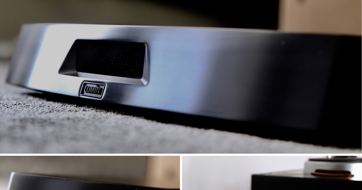

The new Lumin X1 Flagship Roon Ready Network Player inherits (almost) all the features from S1 plus many improvements:
Dual ES9038Pro
DSD512
Femto Clock
New output stage
New power supply
Optical network and copper Ethernet network inputs
XLR, RCA, BNC-SPDIF, USB audio outputs
Peter, I’d just like to say that the Lumin gear is absolutely beautiful, your designer should be congratulated. I have a penchant for exquisitely machined aluminium.
