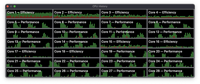

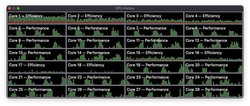

I picked up a base M3 Ultra Mac Studio today. I’ve gotten it mostly setup as my Roon server, and HQ Player is installed. I’m still learning HQ Player, but so far, it seems I can’t really push any further on DSD with the M3 Ultra than I could with the M4 Max version. If I’m correctly understanding what I’m seeing, HQP also seems to be really saturating the efficiency cores, especially core 1.
macOS rarely puts HQPlayer things on Efficiency cores, so those are likely executing something else than HQPlayer.

This is likely the load on Efficiency cores. macOS tends to keep such things there. Although it is not obvious, since the OS doesn’t really tell about details.
