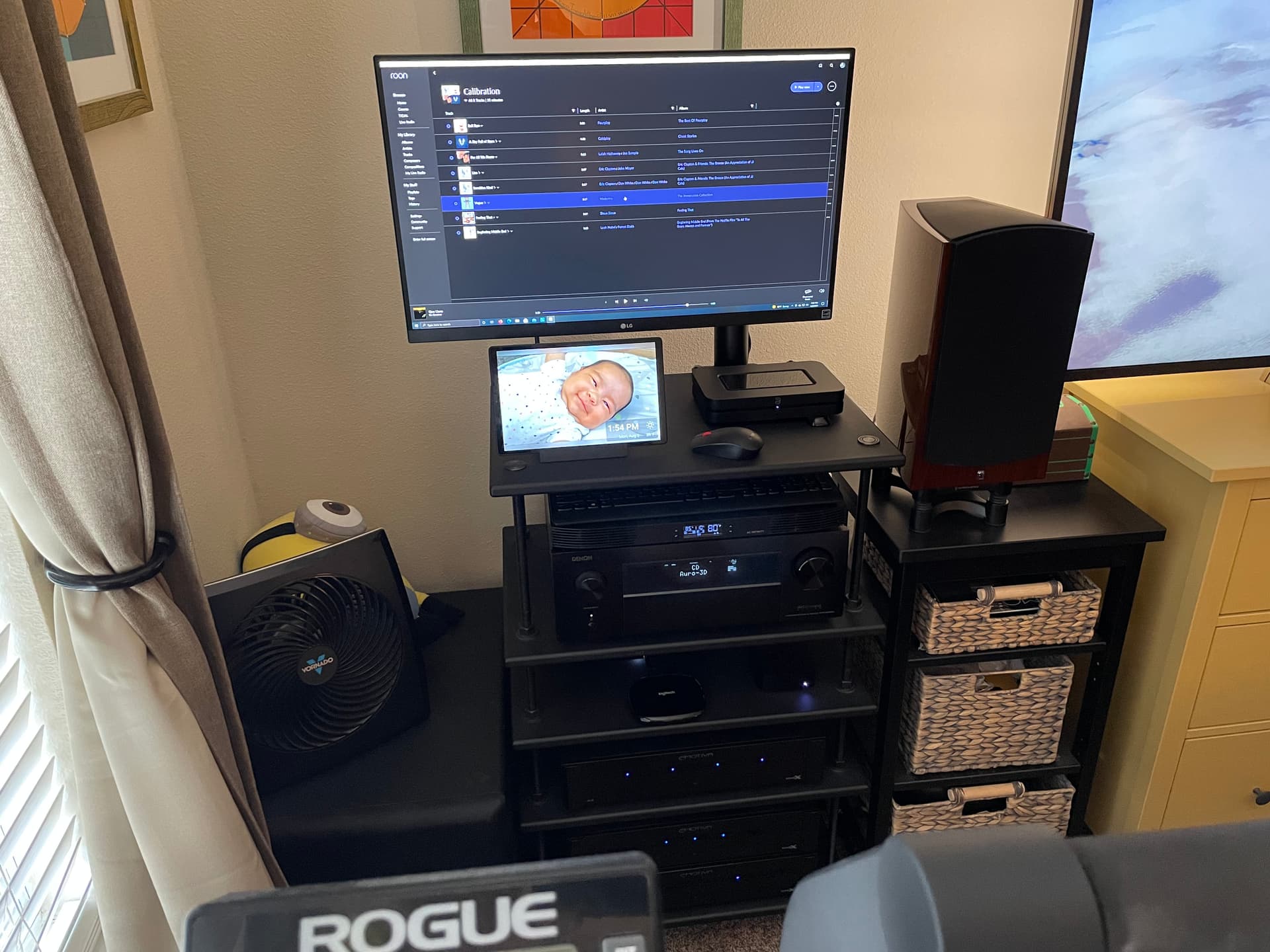

I also own a Bluesound Node (2021 version) which I have in my bedroom setup. While convenient, sound quality is not even close to my MA mini-i Pro 3. I use the Node when listening to music in my bedroom during my Rogue Echo Bike workouts
