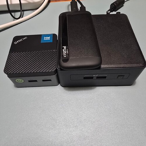

I’ve just setup a GMTek G2 Pro as a replacement MOCK as I was running ROCK on an over-powered NUC (i7-1360p) which I want to repurpose as a Plex server which can take advantage of its iGPU for video transcoding.
I was dubious about how well it would run on such a small device but considered I could always use the N150 based G2 for something else if it didn’t work out.

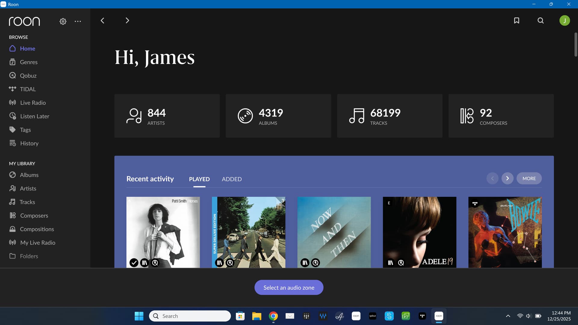

I don’t have a big library (<1000 albums) but all my FLAC is stored on a NAS and accessed by ROCK over SMB so have no need for local storage.

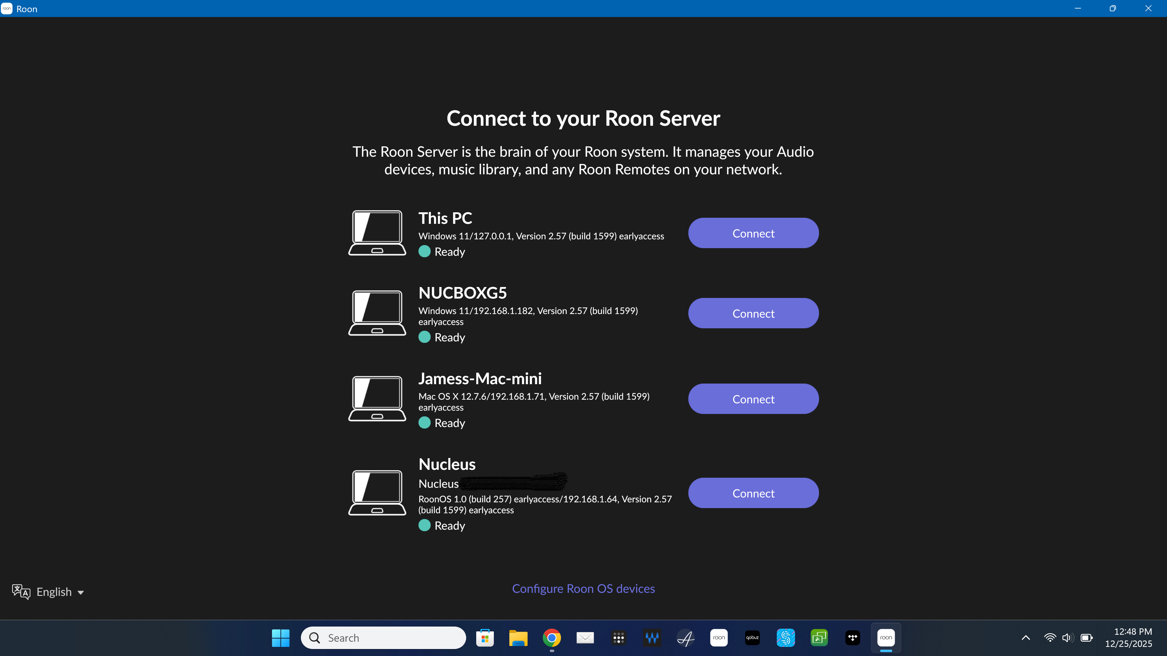

Got windows working on it, just because. Then put ROCK on it and it’s working happily away on a couple of zones and up sampling one of them. All good.

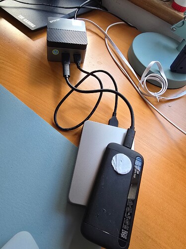

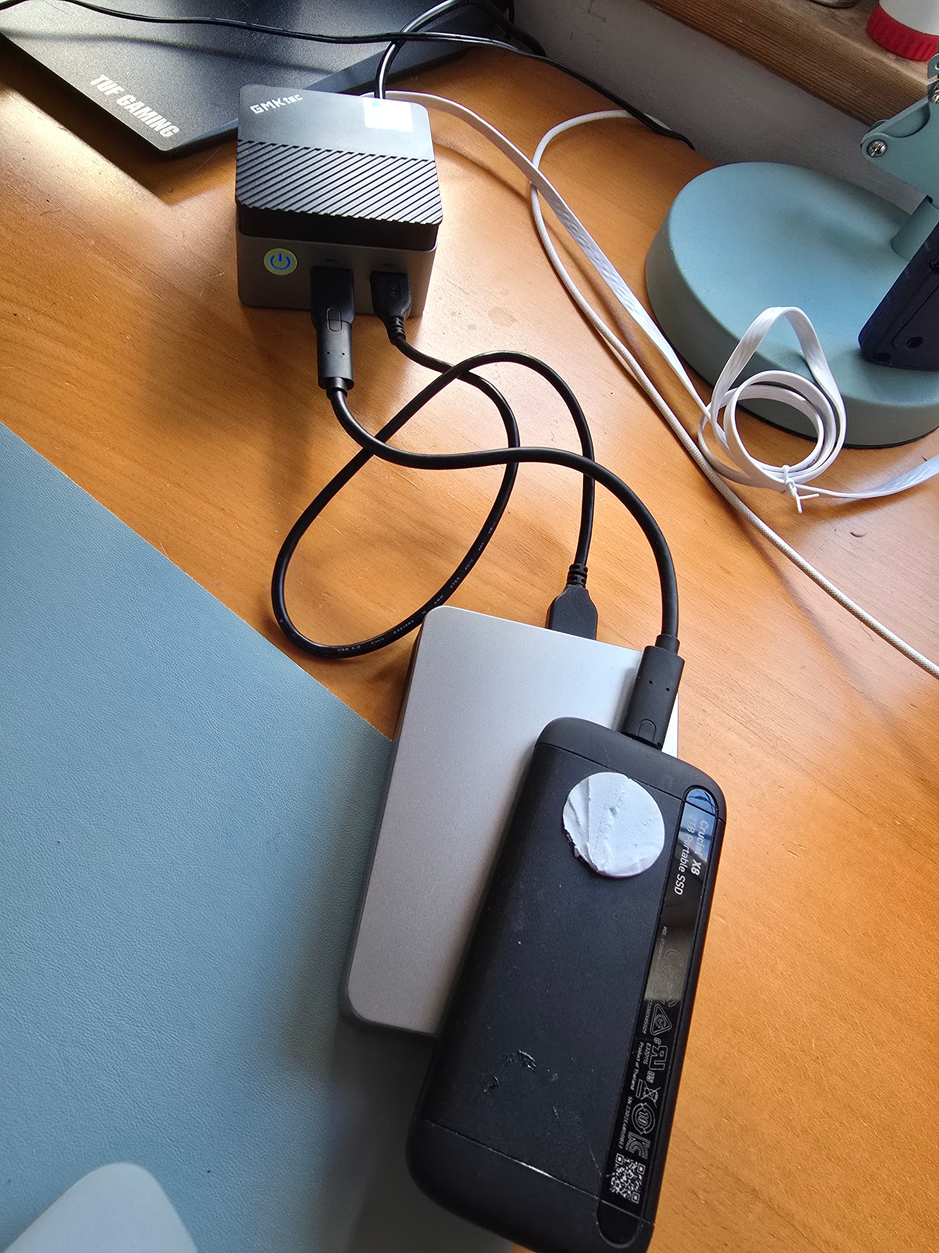

Mine is mid sized I’d say?
Still in setup position on the desktop. An SSD and 2.5 inch HD as storage.

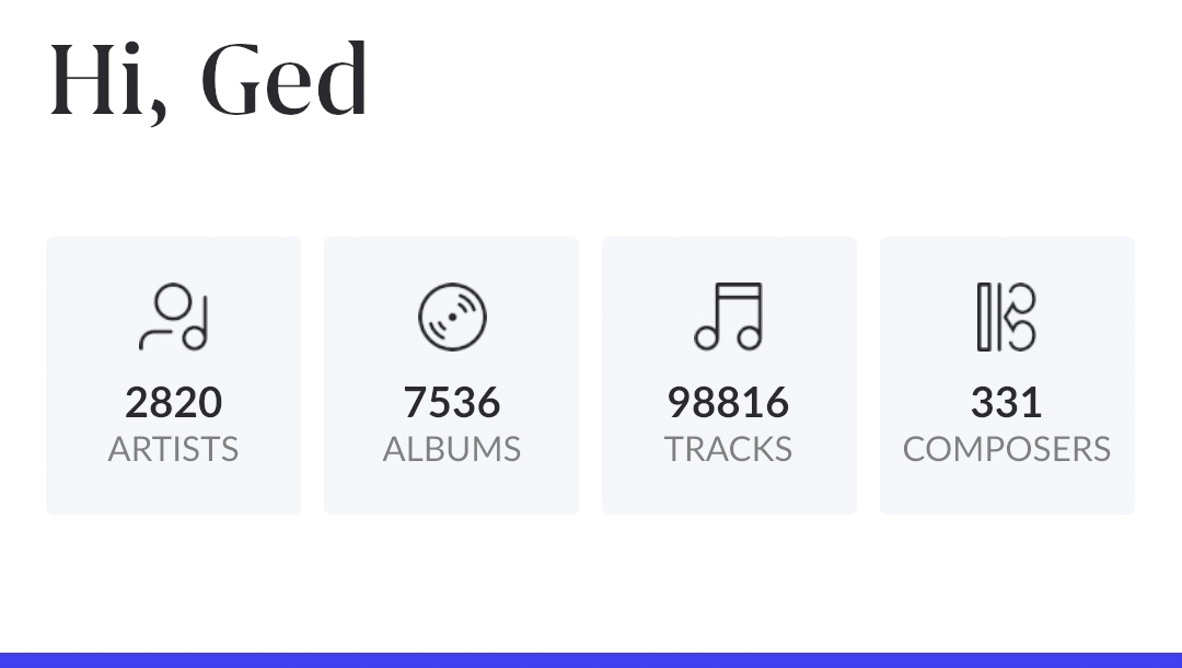

100 000 Tracks is not realy “mid sized”. This is called a big library.
Enjoy your GMKtec N97.
Kind regards, Frank.

I had a duplicates issue after copying my music files from, what I thought as, a clean backup.
Down to 82000 files and dropping :smile:
Is that a good thing?
Yes, if one is removing duplicate tracks.
As @Frank_M says, de-duplicating.
