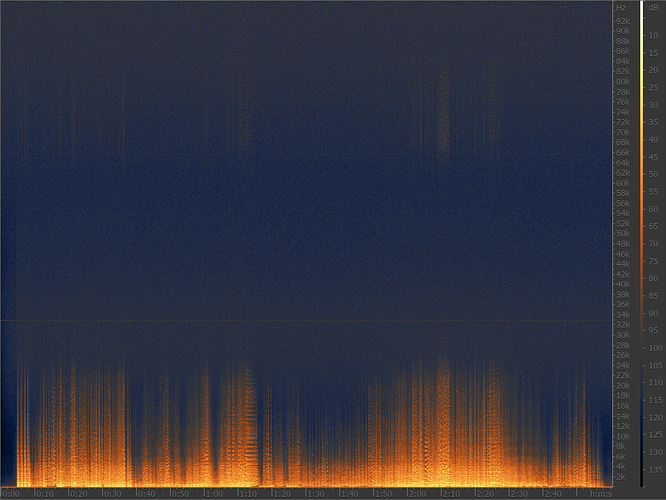

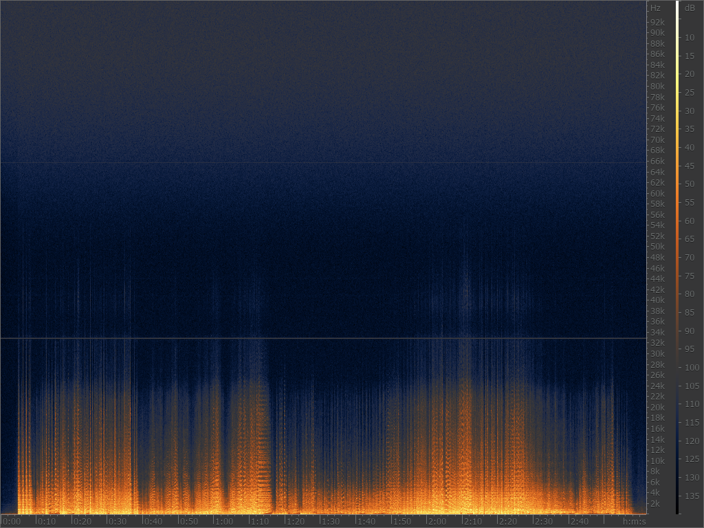

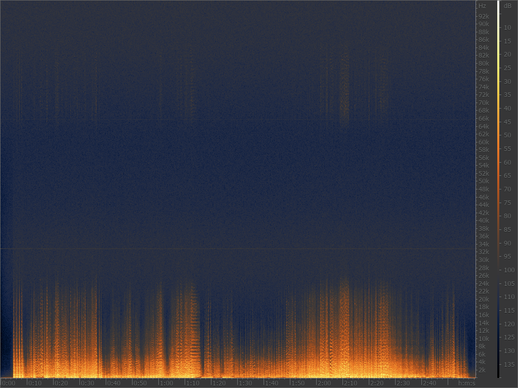

I played same track through same MQA capable DAC and recorded the output from analog outputs of the DAC using Focusrite Forte running at 192/24.
In the following results, lines at 33 and 66 kHz are from the SMPS of the Forte. Increasing noise floor slope at the top is left-over from PCM conversion of the ADC’s delta-sigma modulator running at 6.1 MHz.
First I played the DXD master on-the-fly converted to 192/16 using TPDF dither which consumes about the same bandwidth as the MQA encoded one. This has clean HF content up to about 56 kHz.
Then I played MQA encoded version (with MQA light on the DAC indicating decoding). Now HF content runs out at 30 kHz, then there’s a wide gap and alias images from leaky upsampling filter visible between 60 and 88 kHz. (thus MQA content is sampled at 88.2 kHz and then upsampled through leaky filter to 176.4 kHz)
There is also enough increase in noise floor that the SMPS harmonics almost disappear in the noise.
