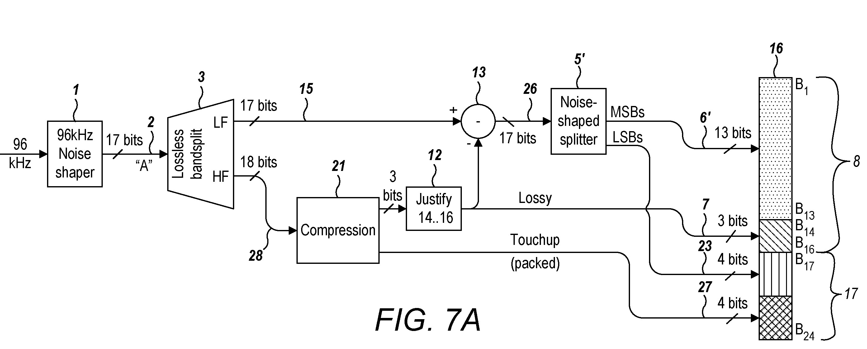

@joel got it slightly wrong I think, and @MusicEar got it more wrong. MQA is completely lossless through the first “fold”. It’s goal is to keep all the data–not that pertains to human hearing, but that pertains to recorded music. By examining a lot of different music files, they’ve determined that musical information–whether we can hear it or not–goes up at most to about 60kHz. Most recordings don’t go nearly that high, partly because the instruments don’t generate harmonics that high and partly because engineers use microphones that don’t go that high.
So, MQA is lossless well beyond human hearing (in the frequency sense), up to frequencies that encompass nearly all musical information–that is, information that does not correspond to noise.
The compression of the noise is lossy.

I admit I’m quite confused by this; maybe you, and @joel, are talking about the generic idea of lossy compression, mp3-style, and assuming it applies to MQA as well? But as I’ve said, up to audio (not sampling) frequencies of at least 44.1 kHz, and often/usually 48kHz–frequencies that completely capture all musical information present in MOST recorded music, whether we can hear it or not–MQA is completely lossless, like FLAC, not like MP3. Except for the first few kHz above that level–a small amount of recorded music has musical information up to about 60kHz–it’s only noise, not music, that’s lossily compressed in MQA.
I base my assessment on extensive reading; I’ve studied the source documents on MQA, including the patent applications, and most of the measurements I’m aware of that I’ve seen online. It’s possible that you are relying on information I haven’t seen. If so, please cite your source. Thanks.
I’m not fixated by “lossless” at all; I have a pretty good idea of what MQA is doing and am quite happy with it.

MQA is only lossy in a technical sense (not able to fully recover mathematically from the original source) that it doesn’t encode the entire rectangular Shannon space… Most of that Shannon space up to 24/192 and above is literally a waste of space, so there is little or no information in this discarded region (If it does, it will be buried under the noise floor) which is relevant to human hearing (this is psycho-acoustics human modelling principle). Thus encoding information can be drastically reduced to flat bit-rate ~1.5Mbps across sampling frequency from 44.1kHz right up to 384kHz and beyond. Thus this save a lot of bandwidth!
There are of course certain conditions HF (high frequency components, above 20kHz) that the touch-up channel can over load, and when this happens it will revert to lossy. Strictly in technical sense its final output resolution can never achieve a true ‘24-bit’ like in FLAC.
So does it really matters? The answer is No! Most modern ADCs and DACs are unlikely to achieve true 24-bit resolution in practice. Does technically lossy in this case which happens in the high frequency above 20kHz really matters? The answer is No! we simply not able to hear information that is near to noise floor or those buried in the noise floor.

The triangular shows in two domains, frequency and spectral level, for frequency up to ~60kHz is encoded and for spectral level, anything below -120dB in the audio band is not encoded, this increases up to well below the -96dB of a 16-bit CD resolution at ~60kHz. So what about anything above 60kHz? It is discarded. Spectral level below -120dB in the audio band It is discarded. Just below -96dB at around ~60kHz, it is discarded. In a classic PCM, it just encoded everything beyond the limits of the triangle all the way the maximum nyquist frequency, thus the bit-rate has to increase with the function of the sampling frequency.

OK, I THINK I see what you’re arguing here. I’ve read similar claims elsewhere. Some aspects of those claims appear to contradict what MQA folks have said publicly about their technology. That makes it difficult to know what to believe. I’ll just note that MQA has provisions for 2x ad 4x transmission rates that would take their lossless compression up to 192kHz/DXD respectively. I’ve said before that I find the compression to be the least interesting aspect of MQA; it seems like something they did to show it off, because it’s clever, and not because it was strictly necessary. Then again, none of this troubles me very much; if the problem you’re describing is real, and if it causes audible problems with complex material, that should reveal itself in time. I remain most interested in MQA’s time-domain focus.
I don’t dismiss theoretical/technical analysis as worthless, as some do. But I’ve seen no objections raised that I find troubling. I’m convinced enough by the technical stuff to believe that it all comes down to what it sounds like.
