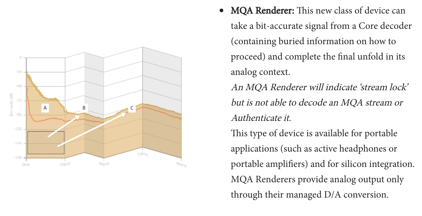

See MQA for civilians in Computer Audiophile. This diagram of the final step illustrates how information is pulled out from its hiding place below the noise floor and applied in the upper range:
