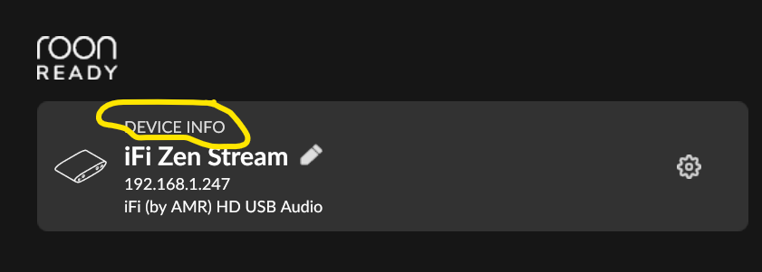

To change between SPDIF (the default) and USB you go to Settings->Audio and click on the Device Info button (if in Roon Only mode) or go to the Web Page (http://ifi.local) if you are in AIO mode. The Roon Ready version can only have one active output and you just need to swap it over
Hopefully this helps a bit.
