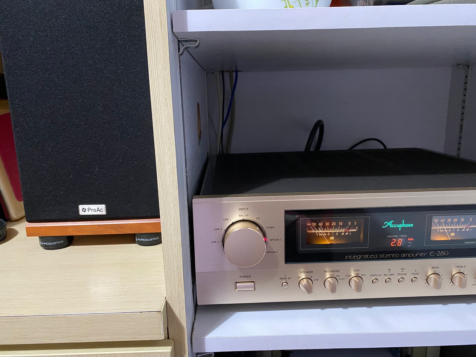

Hi,
I’m a beginner using ifi streamer and HQPlayer. After having a defective ifi exchanged and finally get everything fixed I’m happy with my set up as an NAA for DAC-60 on Accuphase 280 amp.
My Roon runs on an old 2012 Mac mini, 16gb ram, 1TBSSD. I’m having an issue that when I turn off the amplifier and then turn it back on I need to adjust on iFi the volume output to hardware again otherwise no sound.

This is just with HQPlayer using iFi Streamer as NAA and the output sound is through USB (screenshot of HQPlayer settings below)
The iFi feeds my DAC-60. So when I turn only off my amplifier and then turn it on again I need to open the iFi app and change the Mixer Type to hardware again, otherwise, no sound will come out.
Many thanks again!
Moises my guess is when you turn the Amp off it is disconnecting the USB from Stream and it doesn’t fully know it’s there when you turn it back. Can you try it with Roon to see if the same thing happens in AIO mode.
In my setup it comes right back on (but that is in Roon) are you Also able to test it with SPDIF and see if it is the same.
Hi, I’m currently using it on AIO, with Roon and AIO no problem. I’m going to try to give it a few seconds after I turn it on. Is there any feature that keeps locked the Volume to “Hardware mode”?
It’s always just been on on mine, but I am feeding it into a DAC that has only got volume control
Sadly I am away for a couple of weeks or I would put it back into AIO and have a look for you.
Lets see if @Piotr_Pekala or @Steven_Klemow can add some information while I am away
Unfortunately there is no such possibility.
That’s an ugly bug or deficiency in ifi software - those settings (Mixer Type) are being reset each time Zen Stream loses control of DAC over USB (for example when it turns off).
I tried a few times to get any response from ifi - whether they plan to fix that - but they ignore such questions
For the “Software mode” there is a workaround (stay on version 2.30.7 or lower and select DSP Volume Control in Roon). I don’t see any workaround for “Hardware mode”.
