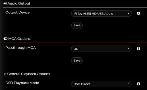

So it seems that after each beta update the defaults on the unit (at least on mine) are set back to SPDIF and MQA back to auto and DSD playback was Dop. I have changed these back to my desired settings of USB output, MQA on and DSD Direct and I have beautiful music now again.
It also looks like all the sources turn back on after the beta updates are installed as well as I can see all mine have become enabled once again.

There are some options below that help as well as the options I posted in the other thread you saw, it may be that not all DACs support this in the beta, which is also suggested by @Katsu_Takenaka in the above thread. I never noticed the Direct DSD/DOP option for some time
the last option is not persistent for me. I can select DSD Direct, but when clicking save it reverts to DoP.

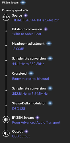

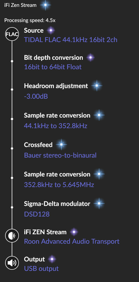

Interesting…when I attempt to upscale to DSD 512 using my Topping D90se (which does support 512), the tracks skip one after the other, consistent with the ZS’s limitation of DSD 256 max. I wasn’t aware that the ZS could handle 512. What did you mean by saying that it works, but that your Zen DAC can’t support it? Do you have the v2 or original Zen DAC, and am I missing something about the ZS supporting 512?
It couldn’t until the last release.
Not sure why it is there if it can’t handle the throughput.
The Ethernet and USB should be able to handle it, but maybe it will improve over time.
But it works with the stable release I seem to remember you said, which suggests some new code needs to be debugged.
Well 512 has always been offered as an option in Roon; before that made sense to me because the bridge directly senses the capability of the DAC attached, not the bridge hardware itself. For that reason, prior to the upgrade Roon offered me 768 PCM as well—after the Roon Ready update it correctly capped out at 384.
There’s still a snafu in the Roon Audio settings, because one of the new DSD options is one called “ERROR”. I just didn’t think the ZS was ever promoted to handle 512. In fact I’ve posed a question to iFi whether a software upgrade could ever allow the ZS to handle PCM 786 and DSD 512–they told me they’d get back to me…

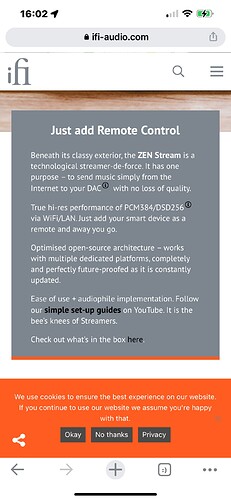

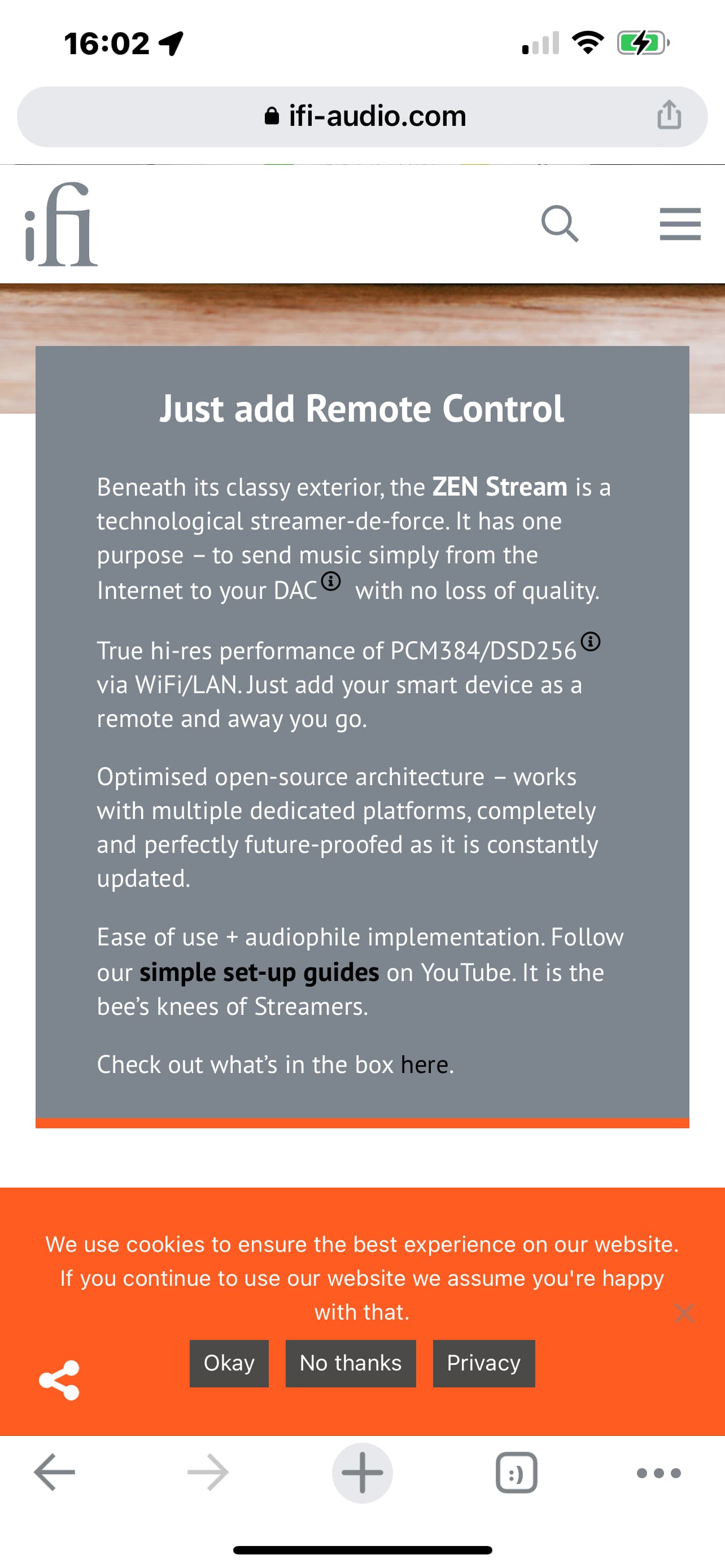

This is from ifi’s website. 256 is indeed the max at this point…
Yes it was originally supported for DSD256 and 384 PCM. I’m surprised that you get 768 which I assume is out of USB and not SPDIF?

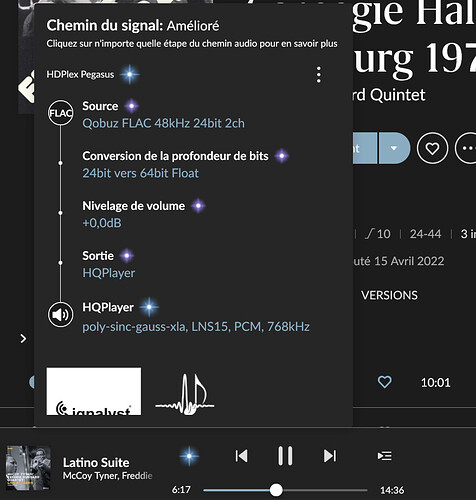

Did you see 768 in Roon or did you play PCM 768 (confirmed by the dac display) ?
That alsa detects the dac settings and displays them (for no reason) in an interface is one thing but for now the ZenStream kernel is still the same (old) and locked in 384.
Example: networkaudiod (HQP NAA) sees the capabilities of the RME ADI dac (768 max) very well but cannot play more than 384.

The stream is displayed… but no sound comes out and the system blocks.
