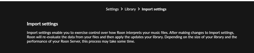

Check out
Thanks. So my primary question would be the minimal, essential tags (before import, which is what I used to do programmatically) for classical.
This article gives guidance on best practice…
And this article gives information about the file metadata entities that Roon takes account of.
How well does Roon work without tags? I have all the metadata I need in the folder/file names.
Composer/Artist → Albums → Tracks
Roon will examine the length of audio tracks as part of the identification process, but having file tags will raise the chances of success considerably.
