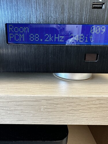

So which is a better setup for highest sound quality:
This is set to decoder only:
This is set to decoder & renderer:

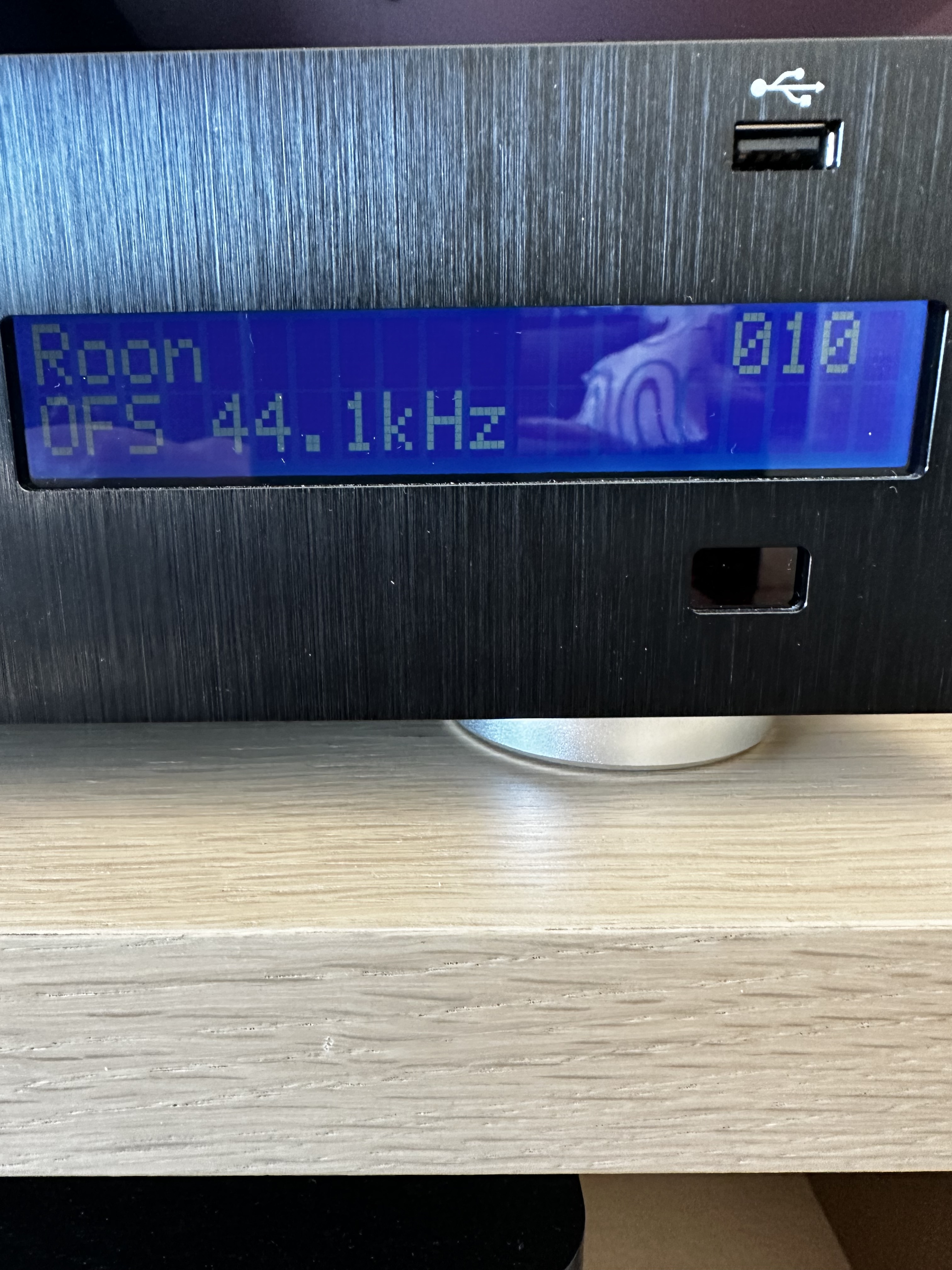

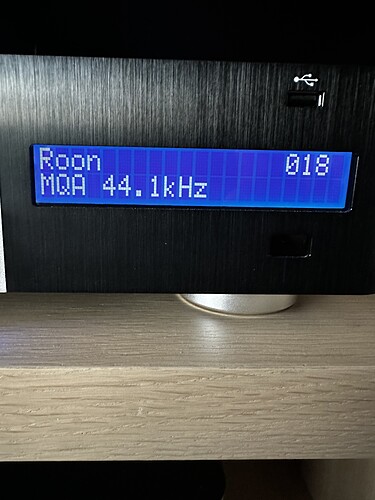

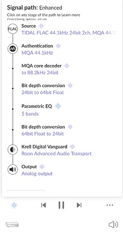

Learned so much here (thanks all) and been doing a bit more experimenting. So if I turn off the parametric eq this is what shows. Krell in device setup is set to decode only and enable MQA core decoder is off.
Once I turn parametric back on and change settings in Krell device setup I can get either PCM 44.1/24 or OFS 44.1 displaying. Is one better vs another?
You need to ensure you use the correct MQA setting if using Roons DSP. Also do not believe a readout for any MQA as it’s all a black box under the hood any way.
The first decode stage of MQA always takes the source material and unfolds it to twice the encapsulated rate so either 88.2 or 96/24. This can be done via Roons MQA decoder or via the DACs MQA decoder. This is always the case regardless of the original sample rate ORFs or ORS.
The DAC can only handle the rendering stage, this bit is where adding all upsampling occurs and bespoke reconstruction filters unique to your dac are applied. What this actually upsamples to is never shown as it’s a black box.
Some vendors mention it loosely by saying MQA x 4 or MQA x8, MQA x16 this will be 4 or 8 or 16 times the original rate. Some will upsample to the highest PCM rate of the DAC. What they more often show on the display is the ORFs or OFS this is the original sample rate of the material before MQA encoding happened not the rate it’s finally playing at.

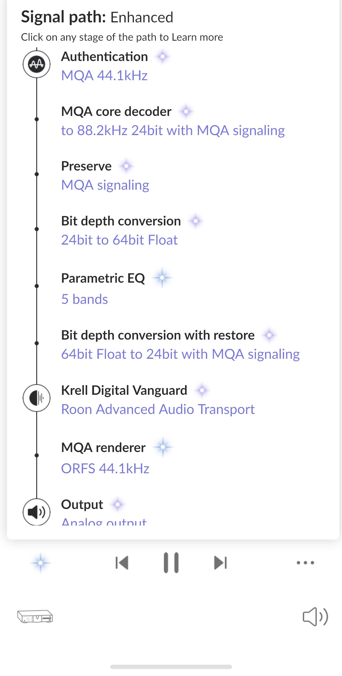

If you look at your screen grabs the one that preserves MQA signalling is the correct setting if using DSP as it will maintain the MQA info for the DAC to carry on and perform the rendering stage. If you don’t then you loose all MQA info the DAC will just see the incoming signal as 88.2/24 PCM as Roon has performed the first decode but not preserved MQA signalling. No further processing will occur. If you are not using DSP then you can have the device set to decode and renderer and let it do it all. There is no difference between letting Roon decode or the DAC as long as you set the right setting to preserve the full MQA signal. But only you can decide though if a full MQA processing chain sounds better than half a one do not believe it showing 88.2/24 is better than 44.1/24 MQA or OFS as those are full MQA decode and rendered streams the former is not. But showing MQA of OFS on the display is the same as one another just in one case the DAC is doing it all the other is Roon and the DAC combined.

That’s a grab without the parametric EQ. I personally love the sound using the EQ so should the settings be in the Krell device setup as decoder and renderer and mqa core decoder is switched on?? If I use these settings, it displays OFS 44.1. Is this giving me the highest possible output preserving MQA using the EQ? Again just trying to preserve MQA and then I can decide which sound I like the most.

It‘s been written before, but I‘ll try to summarize it for you:
Set the core to be the decoder.
Set the Krell to be the renderer.
It makes the core perform MQA‘s first unfold, thus allowing to use Roon‘s DSP functions while preserving MQA information for the Krell to be able do the final rendering steps.
You are getting the most out of it this way!
Stop agonizing and enjoy some tunes, finally…
