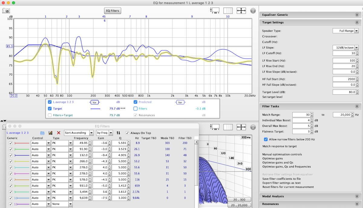

Finally, EQing with REW (left channel shown here)
Shape of EQ filters on top (blue=left, red=right) and final SPL curve including bass trap and EQ at the bottom.
