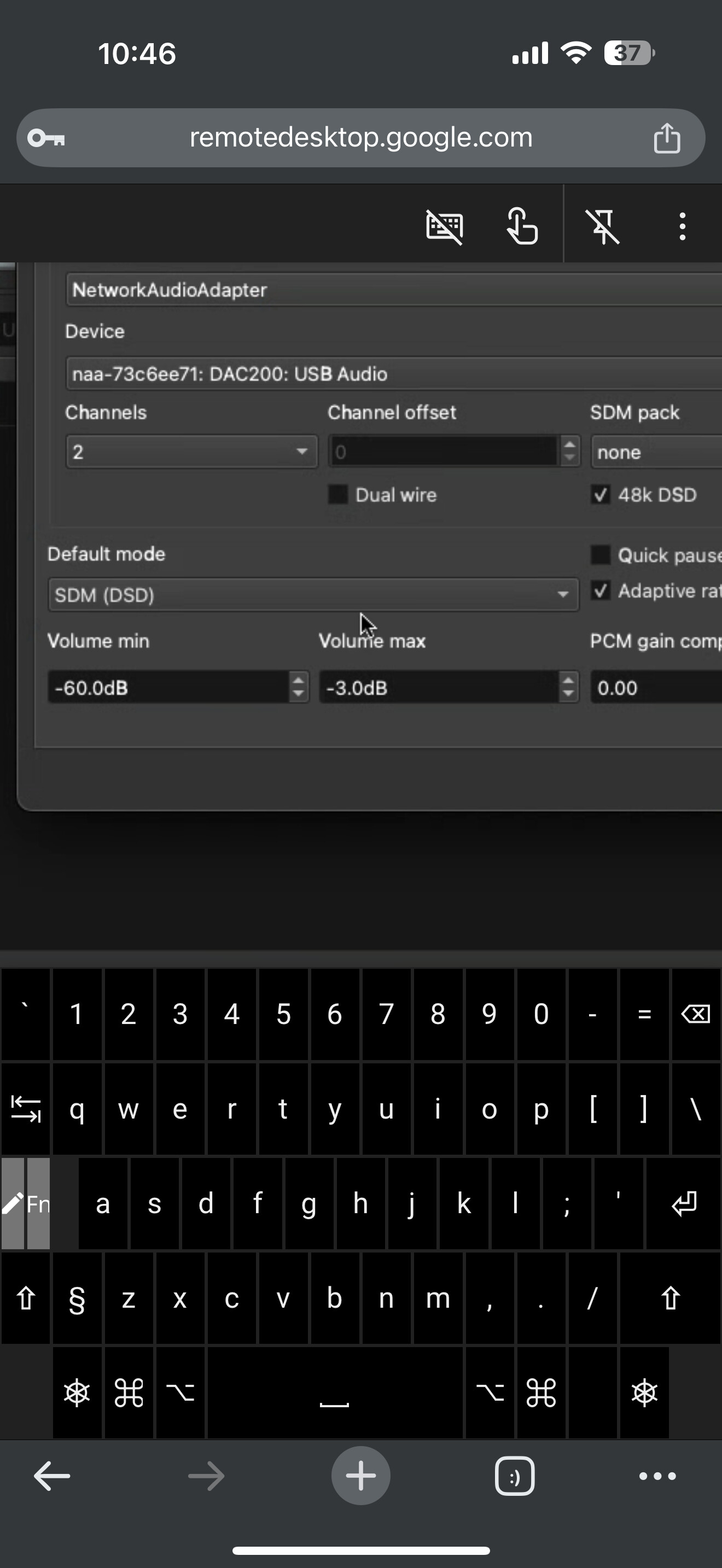

Dumb question…,I have a Dac200 but recently switched from my Hegel h590 integrated to T+A m200 monoblocks.
I’m using the DAC 200 as a preamp too and currently managing volume through the Dac. What’s the best volume control to use with HQP?

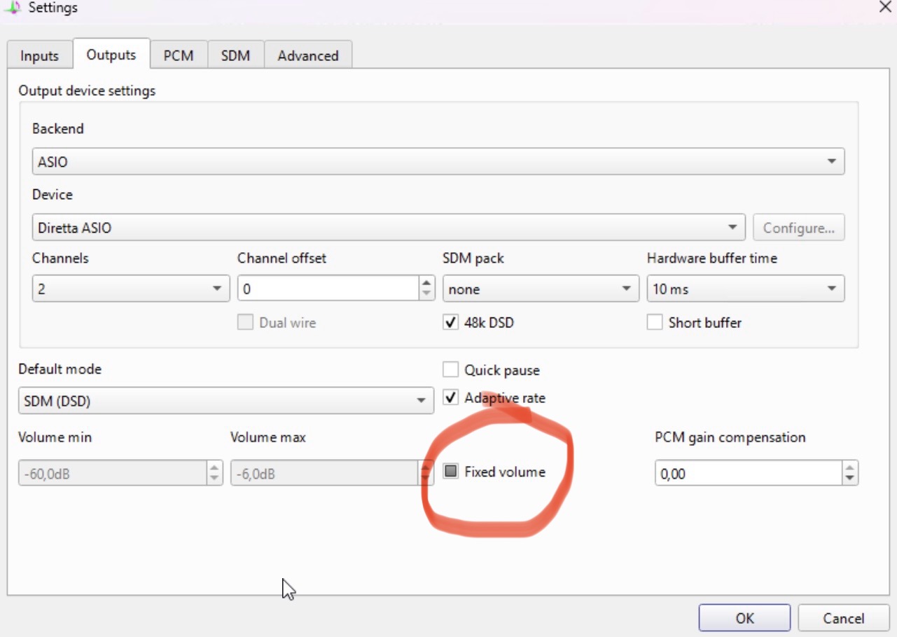

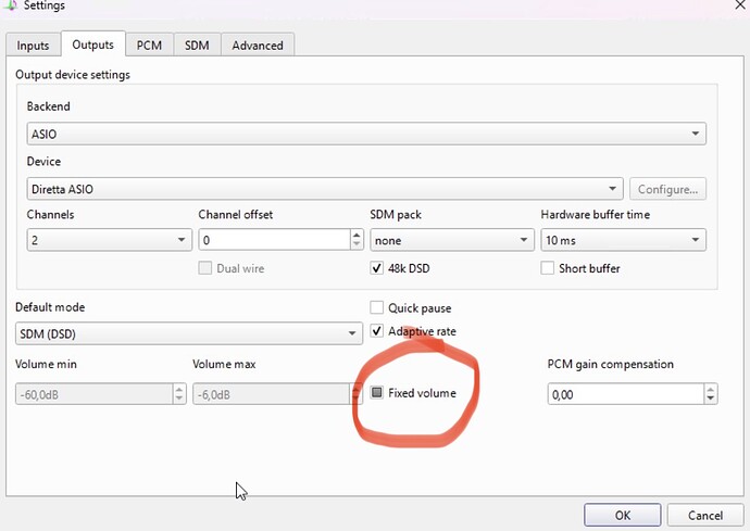

T+A DAC200 has a great analog preamp with relay based volume control. That’s the best way to control volume in your setup. From HQP settings, just check the new fixed volume setting which was recently introduced. This way the HQP volume level never goes above ~ -3dB (or -6dB if the box is greyed).
Thanks! I didn’t see the new fixed volume setting. Where is it? I have already set the max at -3db.
Thanks again!

You could also set the min and max to the same and get a fixed volume of your choosing… :grinning:
It’s not the same thing though, but that is another alternative to use.
