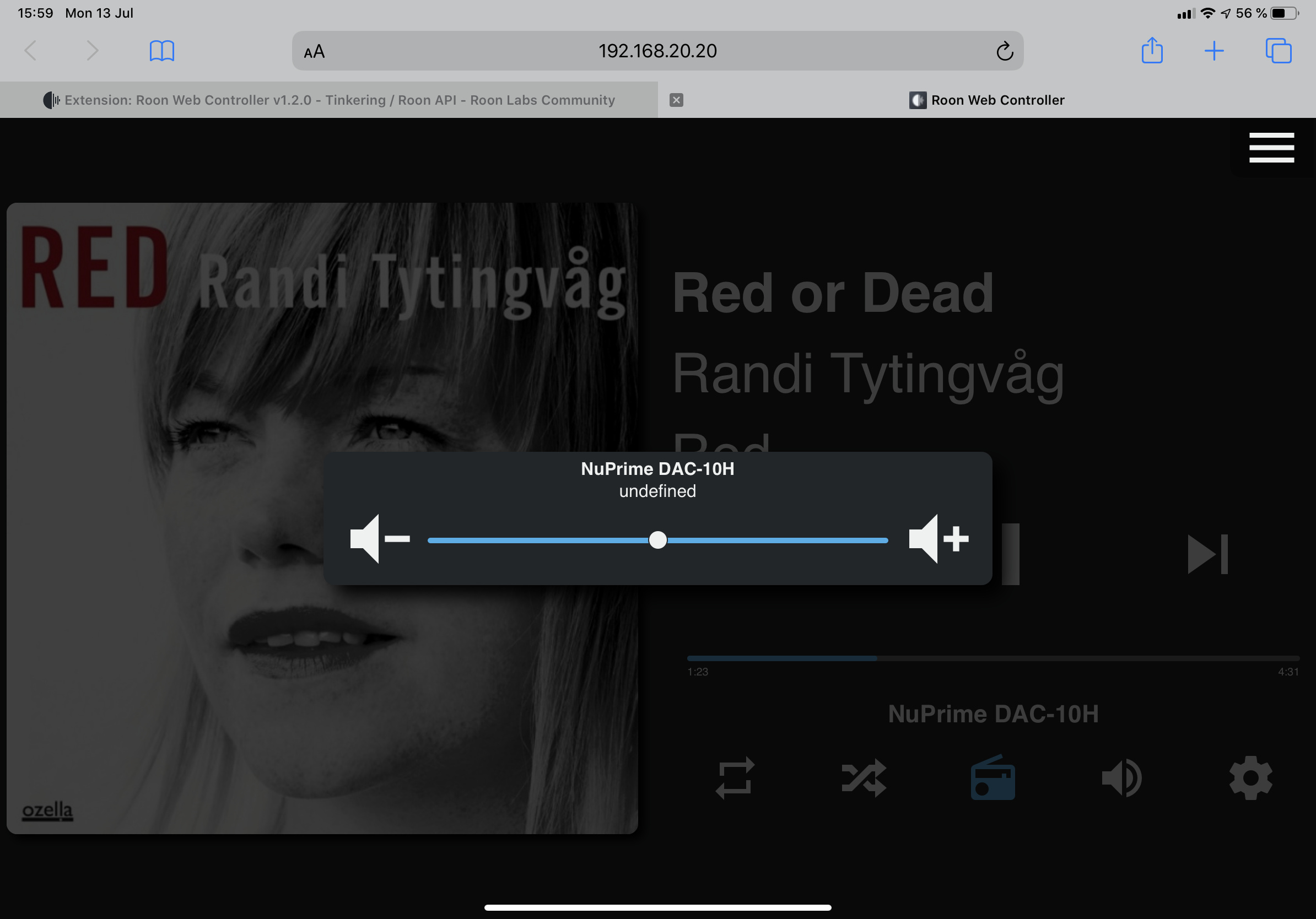

Hello,
I have a problem with volume on another extension - web remote.
It can’t handle volume control when the volume is set to Deep Harmony.
See bellow post.
Any thoughts ?
Thank you
