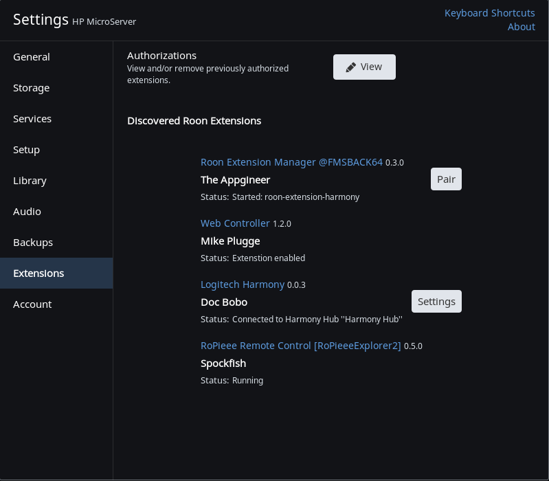

New the Logitech Harmony extension stats "connected to Harmany Hub:
However, in the settings page, I do not see my harmony hub listed.
I have not yet tried if I can use the harmony hub as a remote for Roon.
If you manually update the settings, the Settings UI is pretty much useless. However, there is nothing in that UI that’s relevant - you only use it to select the hub to connect to.
Given that the extension indicated that it successfully connected to the hub, evertyhing should be ready to go.
