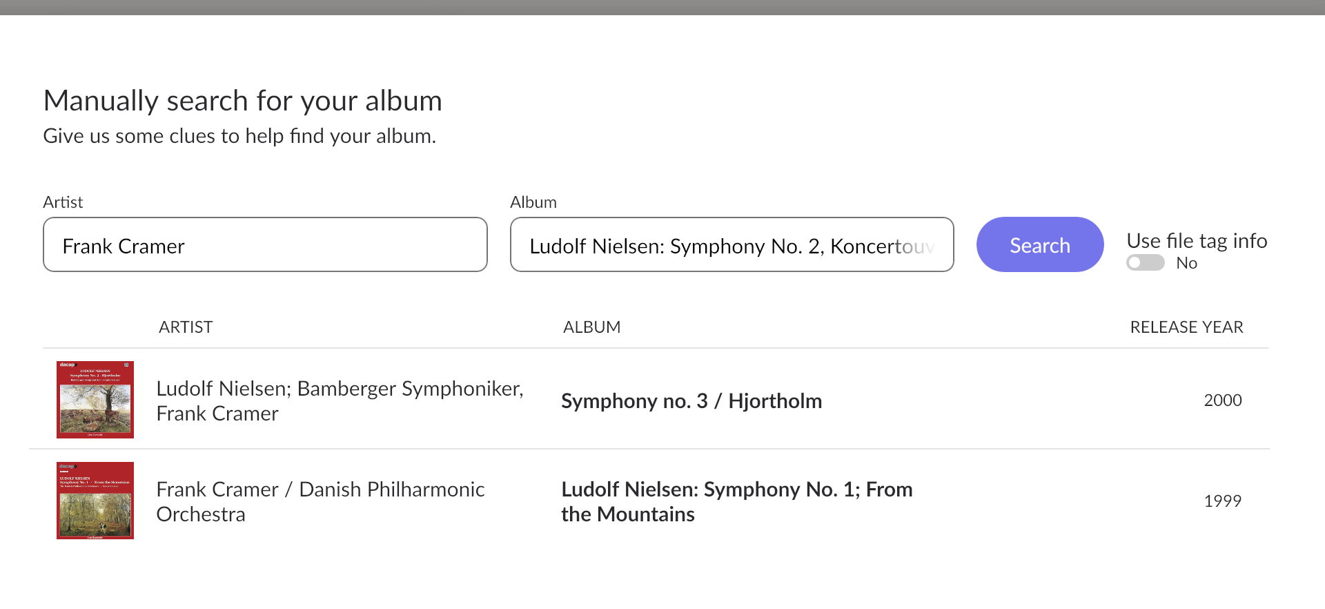

Roon can find a couple of similar albums, but not this one:
No luck with this one either:
Good old Børresen, then? No, not, but wait… there is another record company that started the whole thing for Naxos, called Marco Poly. And that particular CD was sposored by the Danish Radio, so… using various alternative words in the search, trying both Danish and English titles, brings me to something that I trust is in fact the same:

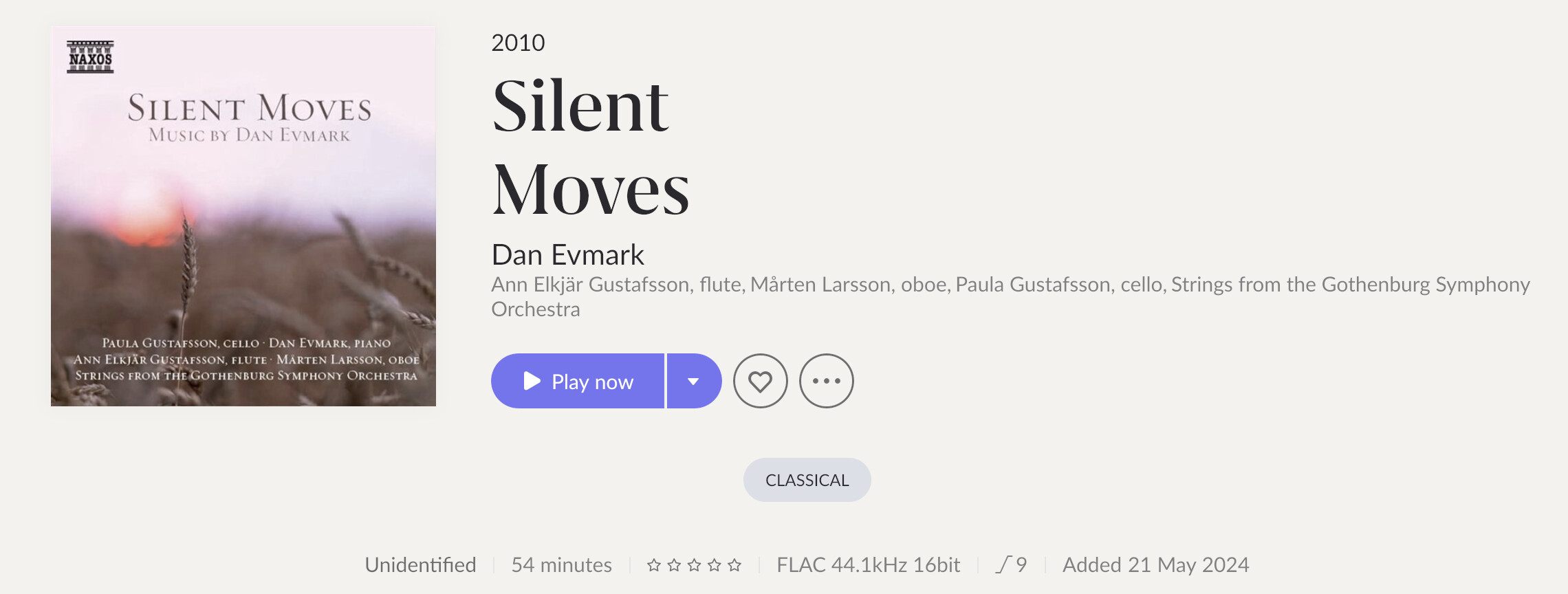

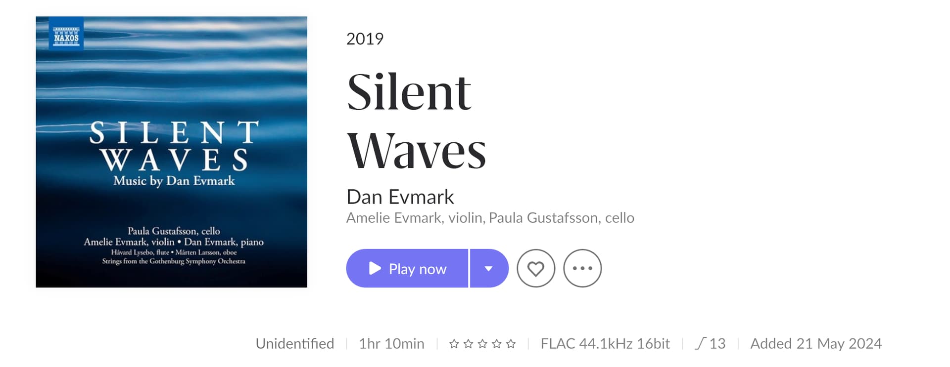

Dan Evmark is a local phenomenon for Sweden, it seems, ans some of his albums cannot be found in Roon:

You are right, this is not identifiable as it is existing neither in Tivo nor MusicBrainz. The latter is explainable as it seems to be a rather unknown composer and merely nationally known orchestra, as you mentioned availability was regional. Naxos not putting up even the title and artist into a database is a bit surprising but maybe originated from that time in the 1990s being kind of a lowcoster not depending on amazon and retailers.

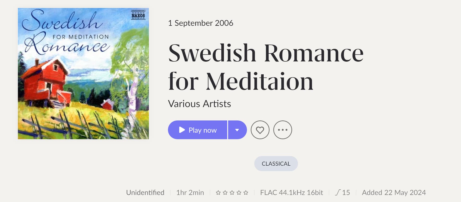

The Easter album seems to be pretty common, has EAN and is still available. If you try to identify it in roon by using solely the album title the results are strange as if they are limited. Maybe the fact that it is a sampler with numerous artists are making it complicated to find it. If it was in my collection, I would start doing some detective work to find it, chances are at least promising.
With samplers and re-releases there is always a risk something might not match or is not existing in a database.
