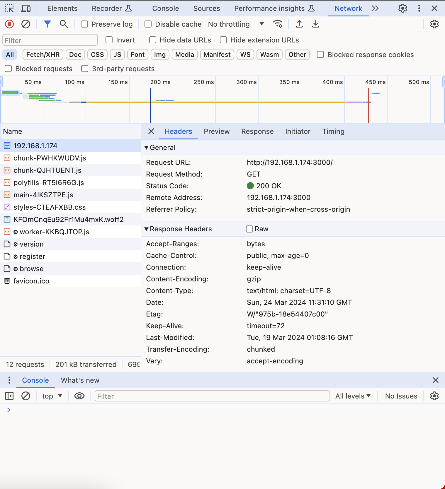

Can you share a full capture of your browser dev tools on the network tab, with the console open at the bottom and the first request highlighted?
100% sure that somethings wrong in my setup.

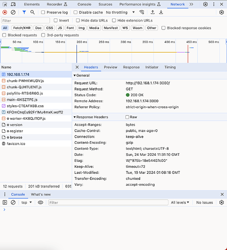

This is what the network tab is looking like with the first request highlighted:
I’m calling http://<ip address>:3000 from the browser

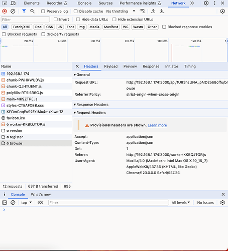

Interesting to see that /api/* endpoints are giving 404:
  "message": "Route GET:/api/register not found",
  "error": "Not Found",
  "statusCode": 404
Although the /chunk-*, /polyfills-*, /main-* js files are getting readily fetched by the browser from the same IP, when I right click on the corresponding request and click Open in new tab. This also rules out any firewall or related network issue. There’s no firewall anywhere in my flat class C home network.
The call seems to be pending at the browse request and I’m getting a 404 if I try to open this request in a new tab, like the other /api/* requests as explained above:

I guess it would be useful to know why the browse call is pending as can be seen in the Chrome network tab…
