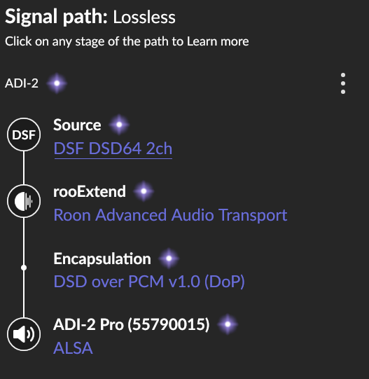

RME ADI-2 and also the pro models support DSD playback and it nicely works with the rooExtend SD-Card-Image and the included Roon Bridge. I just set it up running here in my study.
In the Device Settings in Roon you have to select DoP which encapsulated the DSD stream in a PCM frame.
Using this gives no degradation in the Sound quality at all. Only the package format is different in which the DSD data gets transported.
This gives you a signal path like this:
At the analog output of the ADI-2 you get the pure DSD signal.

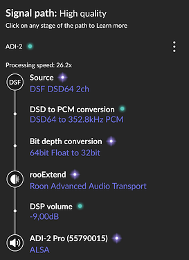

Using this you cannot change volume of the main analog output of the ADI-2 nor insert any DSP on the Roon side. Using any DSP it Roon, Roon has to convert the DSD to PCM first before being able to add DSP filtering. Adding DSP volume for example you will get a Signal Path like this:
This is just how DSD works. You only can get the 1:1 anlog output with DSD.
