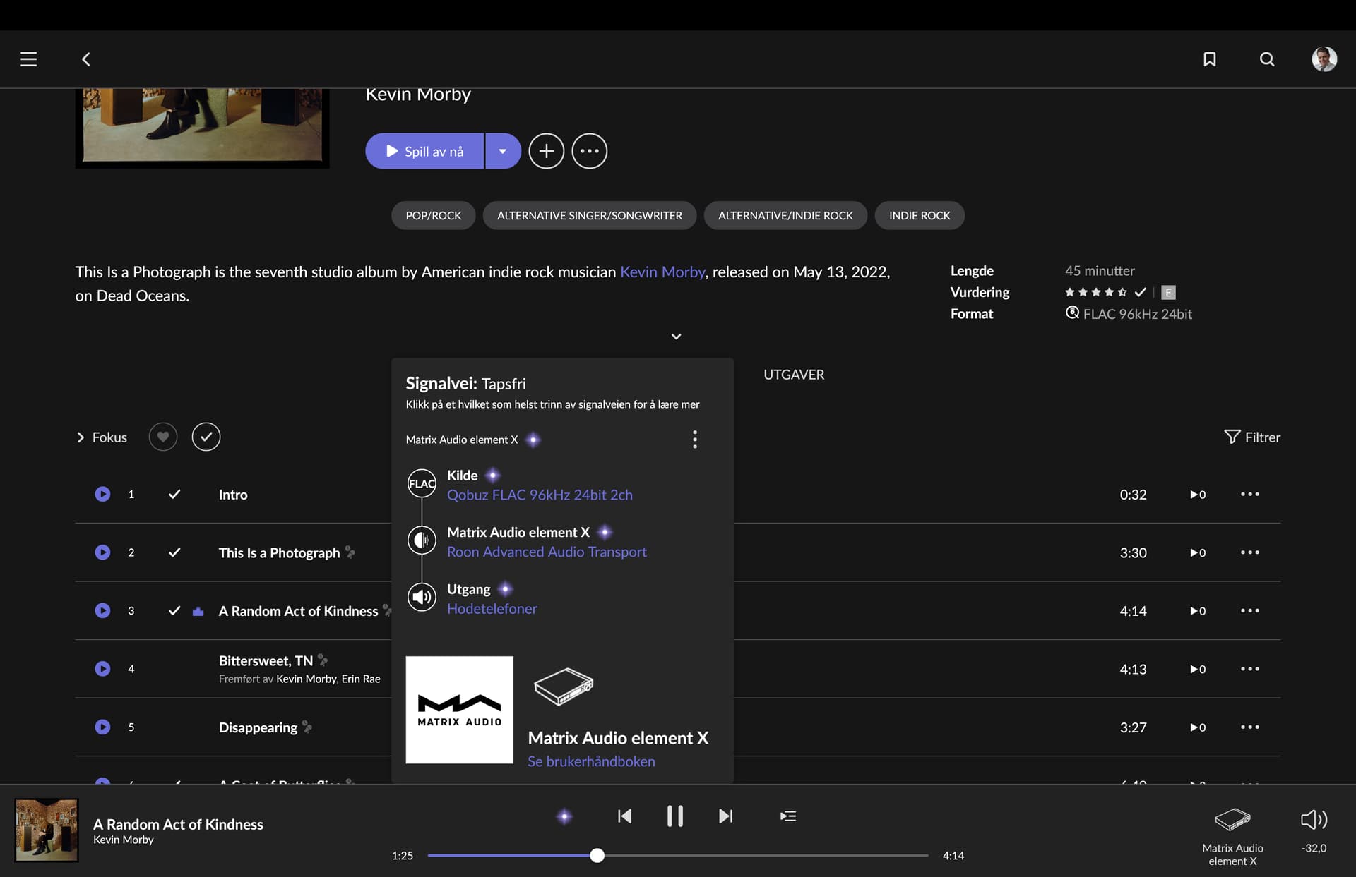

OK, so I’ve dug in more. I’m finding mixed bit depths on some Qobuz albums. So it’s just some tracks on the album. The 16 bit tracks all initially display as 24/96, then immediately the display steps down to 16/96. My guess is that while Qobuz may label a whole album as 24/96, in some cases, the actual tracks are a mix of differing bit depths? Curious.
For example, on Kevin Morby’s album, This is a Photograph, I’m seeing 24/96 for track #1 and #2, then 16/96 for the rest.
Similarly, on Cassandra Jenkins’ album, (An Overview on) An Overview on Phenomenal Nature, I’m getting 16/96 on all tracks other than #4 and #5.
For both of these albums, TIDAL only has the 16/44 versions, so I can’t compare how bit depth is across platforms.

@RBM is your DAC confirming what Roon signal path says? Sorry for not being clearer, but what I’m seeing is that Roon’s signal path reports 24/96, but my DAC is receiving 16/96.
@CrystalGipsy definitely shows as 24/96 on Roon via Qobuz for me.
@SukieInTheGraveyard sure, but that’s what I’m trying to confirm here, whether it’s just on my end. Does your DAC report bit depth, and does it accord with Roon’s signal path on these Qobuz tracks?

It’s worth presenting your finding to Qobuz themselves. Qobuz do have albums that show as Mixed Format (see below), but obviously that’s not what your talking about. Roon will take the format info straight from the Audio Properties of the streamed track, so I’m assuming that’s showing as 96/24. Very strange.
From the Matrix Remote app while using the Matrix Element X as Roon Ready endpoint.

Seems there are some “mixed format” albums on Qobuz that aren’t labeled as such. Also interesting that Roon’s signal path (and perhaps some software-based DACs) appears to report the label from Qobuz without checking the bitstream.
Anyhow, not complaining, just a curious finding.
See zero padding.
Among DACs that report word length, most report full logical word length. Some DACs, though, report only active word length, that is full logical word length minus any LSB zero padding (e.g. 24 bit - 8 bit zero padding = 16 bit).
