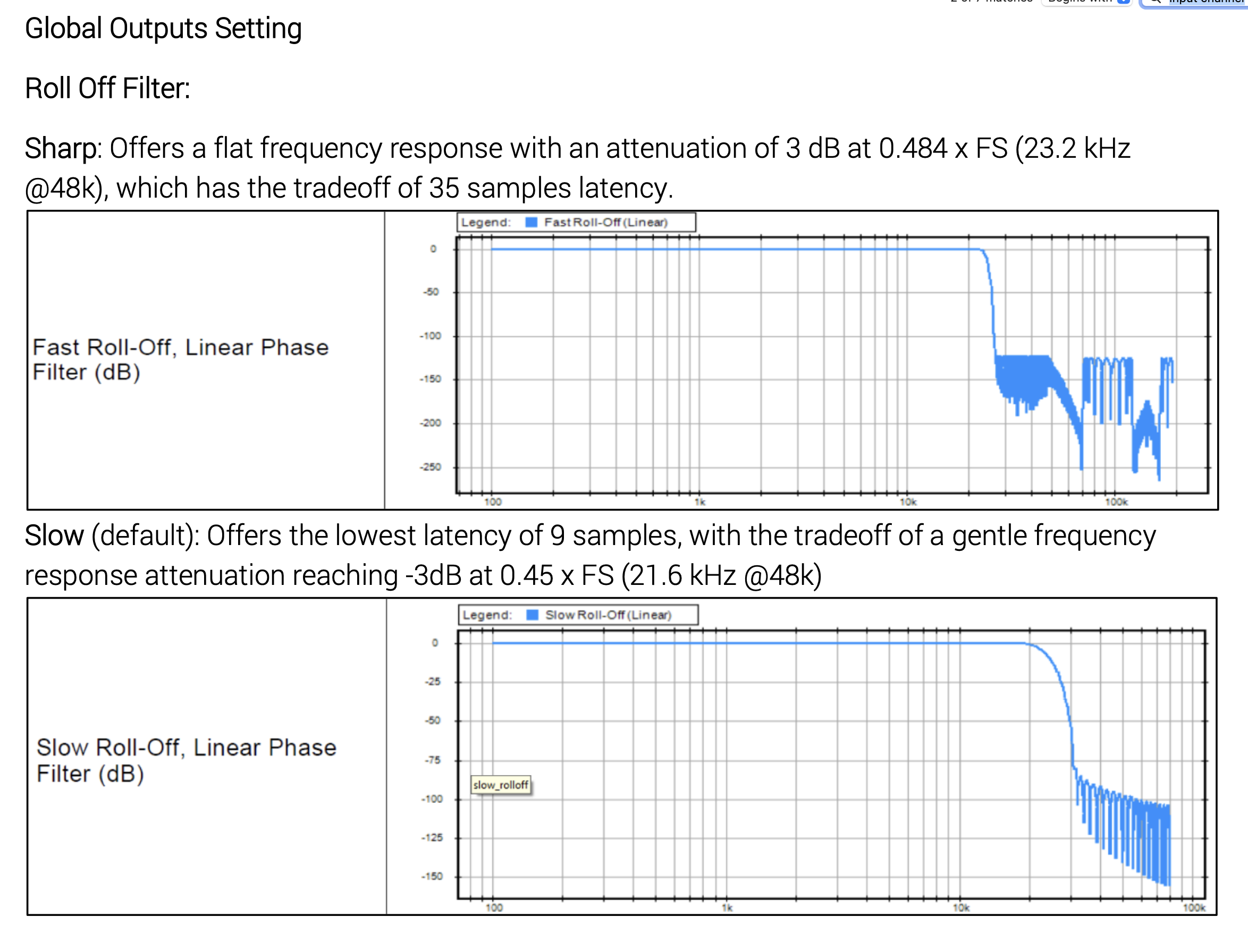

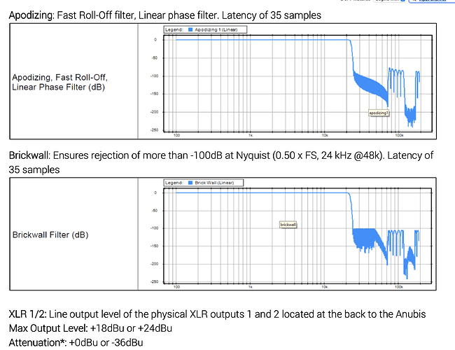

Currently resting ears. However found this in the Anubis documentation. The output setting was on the default “slow”. I guess I should have tried “Brickwall”.
Those apply to PCM inputs.
Their system for port numbering is super-confusing. The input XLRs (8, below) are labelled 1 and 2. And the output XLRs (7, below) are ALSO labelled 1 and 2 !! I’ve put stickers on mine to make it clearer. Pretty sure these are the output settings, as per text at bottom of previous post’s images. (To make it worse they have some 1/4inch jacks labelled 1, 2 on the back and then some 3, 4 jacks on both the back and the front!)
