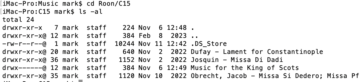

For instance, this is a listing of the contents of that sub-folder on macOS:

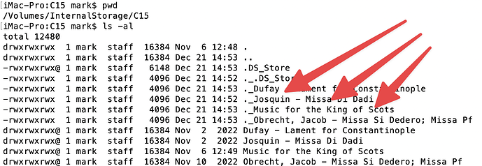

which - once on the Nucleus - has these extra (presumably hidden?) files/objects:

I think those might be hidden files MacOS creates to store its own metadata about files. One of the reasons all Apple products are banned from my network… I don’t think Roon creates them, at least I do not see anything like that on my Synology Roon core…
I don’t have these when I ls -a my music folders on the Rock that is mounted on Mac in the very same way

Yes, macOS creates a .DS_Store file in every directory; I was sort of expecting that.
But the four same objects but prepended with ‘._’ for each of the directories containing the FLAC files I was not.

I don’t have the extra four objects with those prefixes in the corresponding location in the CCC backup which I made as a test. Nor, as I say, in the ‘original’ location on my iMac from which I copied them.
However, I just looked one from the Nucleus. This is what I see:
cat ./._DDufay - Lament for Constantinople
Mac OS X        	2??ATTRo??*?*$com.apple.metadata:_kMDItemUserTagsbplist00?      This resource fork intentionally left biMiiMaiMiMaiMiMaiMaiMiMiMiMiMiMiiMiiiiiiiiiiiiiiiiiiiiiiMac-Pro:C15 mark$
So I suppose it may be a way of Linux or Roon OS dealing with the (extended attributes of the) old division between Resource and Data forks on which macOS still builds for HFS, HFS Plus, and APFS, which of course I’m using.
The venerable Howard at Eclectic Light provides even more re-assuring info on it.
And so - yet again - I’m probably worrying over nothing. I’d just like to be sure :slight_smile: .

That’s what I was worried about. No, the original location on my iMac and then again after the CCC clone from the Nucleus don’t have them. It was the first and only (so far!) drag and drop from iMac to Nucleus when they appeared. I now suspect Extended Attributes which Linux/Roon OS ignores. But I’d like to be sure. I can’t find it documented anywhere; yet.
