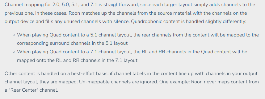

I have a 6.0 in the living room. Before the problem arised the surround channels form Quad files were routed to the Surround back channels according to their Knoledge base. When the problem with downmixing started the same Surround channels were routed to the Surround side channels.
And the downmix to stereo did not work any longer.

From what I understand when playing Quad 4.0 on a 5.1 system like mine, the sub and center channels are not active since the 4.0 signal doesn’t contain these channels. Roon sends the two front channels in the Quad signal to the front speakers, and the two rear channels in the Quad signal to the surround speakers. In my testing, this is how it worked.
Now that I think about it, I shouldn’t be using the term “upmixing” since I don’t believe this is what Roon does. Roon is simply remapping the existing channels in the original signal to the most appropriate channels in one’s system. It’s not doing any “upmixing” to create additional channels not in the original signal (such as sub, center, etc).
Unfortunately, I don’t have any Quad 4.0 content other than the channel identification test album I referenced earlier in the thread (they are flac files). Nor do I have the ability to test if the rear channels in a Quad 4.0 signal are being remapped as described in the Roon KB to a 7.1 setup.

…and I am quite sure that you are right here again, as it was exactly what happened when the problem arised. On the Quad files the Surround Backs suddenly went to the Surround Sides, hence the silence in the Stereo downmix. The question is: what have they done during the update to 17.610

Years ago when Roon worked fine the surround channels of the original Quad files were sent to the Surrund Backs in a 7.1 System, as described in the KB
During downmixing to stereo Roon then downmixed these Surround Back channels back to the front and until this day this did not change. What changed however was that Roon changed the Channel Mapping of Quad files fromt the Surround Backs to the Surround Sides during playback, hence the silence during convertion to Stereo. In other Words: the KB is wrong on that part.
As long as you place the surround channels to the sides instead of the back channels you should be fine.
