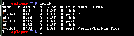

PS - an internet search led me to try this to see if the Salkstream sees the sdb1 drive. If I’m reading this correctly, it does see the drive?

If I run ls /media/, I only see the other drive that’s still mounted
Screenshot 2025-10-27 214431
The Seagate Backup drive doesn’t show up, presumably because I unmounted it (though it’s still physically connected)? Accessing the Salkstream’s “Media” folder from my PC, all I see is the Backup Plus folder for the other drive. The Seagate Backup folder disappeared when I unmount the Seagate drive.
