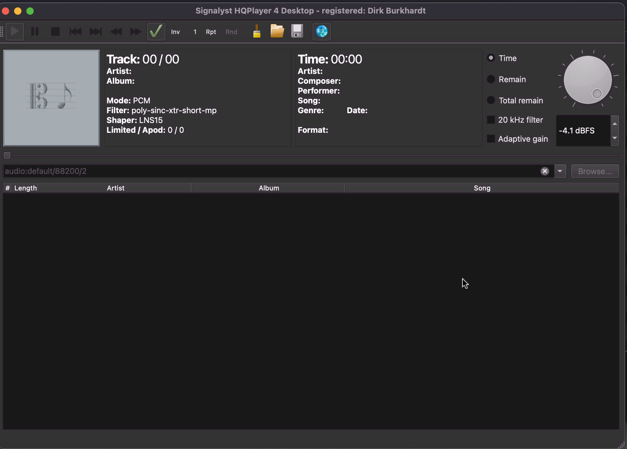

What I couldn’t understand from this thread is how to specify the UAC input on HQPlayer Desktop (not embedded!) as I don’t know how to find and edit a hqplayerd.xml on the desktop version as it’s just a daemon, or is that input yet preconfigured on HQPlayer Desktop so I just need to select it like this?

I managed to select an URI and hit play but still no different target visible on IOS device
You have same NAA, called “naa” defined for both input and output. This won’t work, so the input side will fail because the NAA is already busy with output. You can have multiple NAAs on the same network, but they need to have unique names.
Here it is not appearing on the transport track list below. So it is not working.

the mentioned examples in the QuickStart guide refer to only either "Audio:default/samplerate/sequence number or files from local library.
Am I right assuming that I need to select one of the “Audio:default…” entries - though this will mean I will have a fixed sample rate and not a variable one?
If you say both input and output NAA cannot have the same name, do I then need to rename the NAA name for the input device in some hqplayerd.xml as I read before in this thread - thus I was asking how to edit that file on HQPlayer Desktop, or do you say that name is overwritten by the input URI mentioned before?
“default” points to the default input device selected in HQPlayer settings.
Yes, you will specify some startup rate, but it doesn’t mean that it would be fixed, it can still change.

ok, so the default device then is the “naa: USB Audio Class 2” device selected in the settings menu, right?
