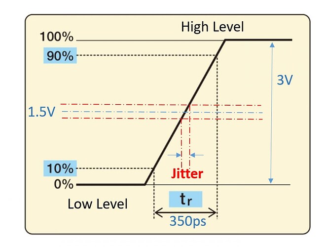

Since you mentioned the laws of physics and basic mathematics, I did a simple thought experiment to see what I could come up with as one of the factors.
I have tried to put numbers on it, but it is not a technically correct example. I have tried to be more specific than phases of the moon or virgin sacrifices.
The purpose is only to share an image, so welcome your frank opinions and rebuttals.
Let the voltage level of the clock signal be a standard 3V in TTL. Let the rise (fall) time of the signal be 350 ps (1 GHz in bandwidth).
Assume an ideal clock with zero jitter.
The reference point for the time axis is the midpoint between the H- and L-levels, i.e., the point where 1.5 V is cut off.
Assume that the jitter allowed for high-quality music playing is less than 1 picosecond.
In this case, the allowed threshold voltage error is ±3.5mV.
If the clock signal level is LVDS, the value will be an order of magnitude smaller.
This level of voltage noise could easily be caused by an input signal, if a noisy signal comes into the DAC, or if the processing load on the interface board within the DAC fluctuates too much, it could upset the ground level, power lines, and of course the threshold potential, leading to jitter degradation, or SQ degradation.
Again, the above is not a strict or correct argument. It is only intended to give an idea of the importance of the analog quality of the binary signal input to the DAC stage.

The 350ps rise time is taken from the maximum master clock frequency of about 98MHz when using the ES9038PRO in sync mode, which gives the best sound quality.
This figure is used to estimate the effect of voltage noise level on clock jitter, and has nothing to do with Ethernet-level packet cycle times.
