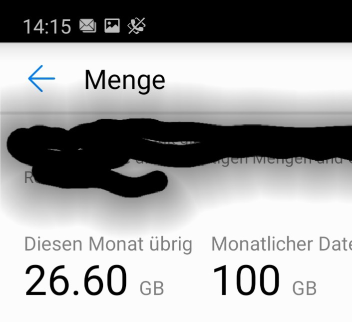

Well, out of curiosity I tried a comparison, being quite surprised by the result.
I played the same track via Qobuz and via Roon app, with my iPad Pro as output device.
CD quality output I set in both apps and deactivated the cache in the Qobuz app.
Having a 100 GB mobile data plan, I can control data consumption by viewing my router (Huawei B529s-23a).
The left-hand side shows the amount of data left.
Data needed via Qobuz: 0.17 GB
Data needed via Roon: 0.40 GB
Album: Kind of Blue, 50th Anniversary (Legacy Edition, Remastered, Doxy Collection)
Track 5. Flamenco Sketches, 09:26
Same parameters for both tests - network, location, devices, time 6 min later, no DSP, Qobuz cache deactivated, CD quality.
Network TELEKOM LTE:
