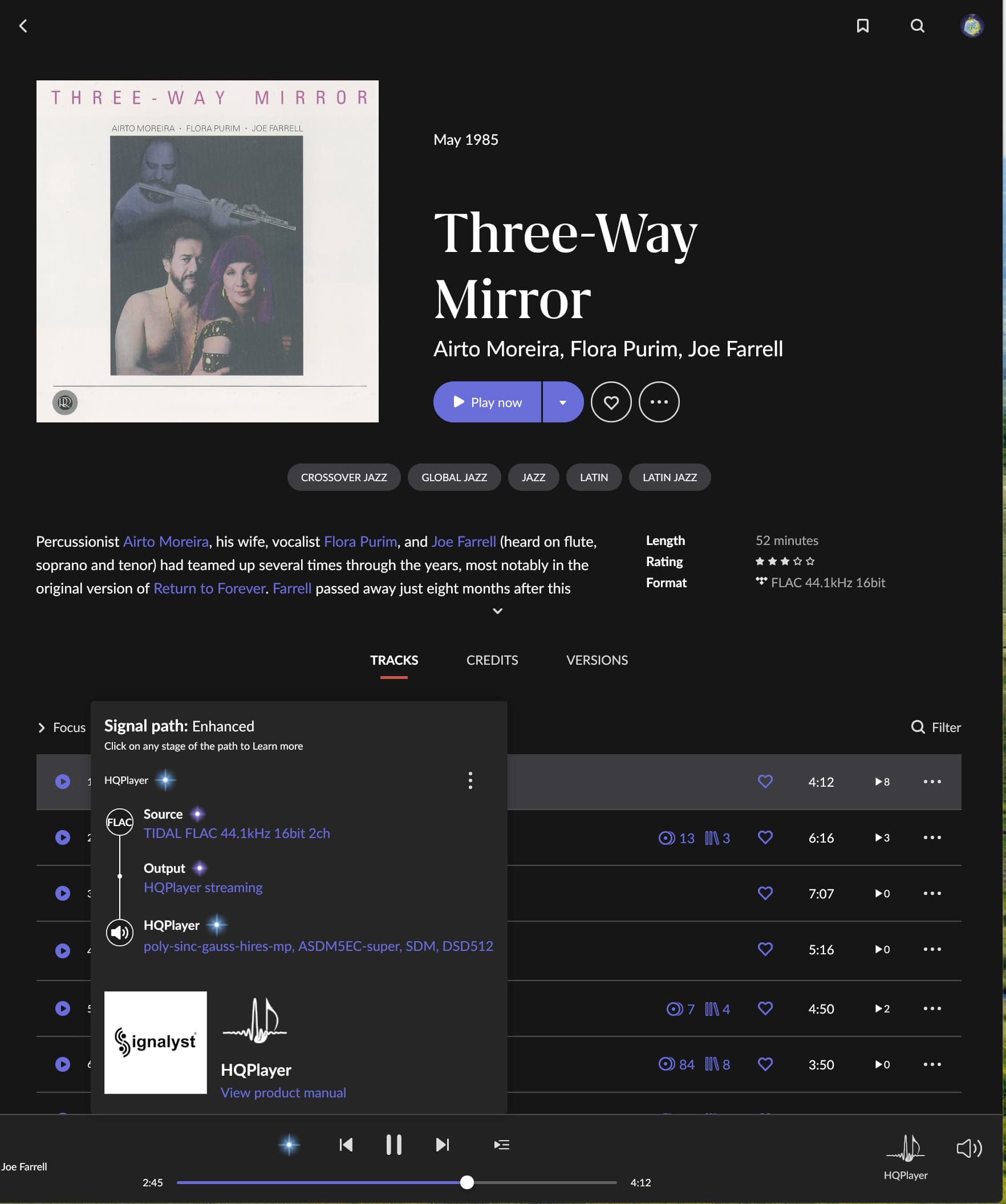

Where to put HQPlayer in the chain?
Thank you. Do you know if there’s any instruction on how to install it on the RED?
Use a spare sd card, (do not use the stock sd card that comes with the red). Use Balena Etcher to write the image file on to the spare sd card, insert to the Red and power up
May i ask which filters/modulators you’d recommend using with this type of hardware?
The my ears the Modulators make a lot difference. I use the '5" series as I have a DAC that uses an ESS chip but feel free to experiment.
