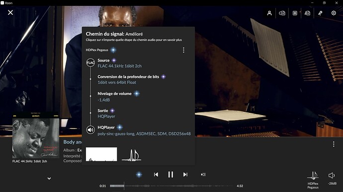

so, whats your take on what I have added? …im upsampling to 352.8/384
PCM settings
1x Filter - poly-sinc-gauss-xla
Nx Filter - poly-sinc-ext3
Dither LNS15
Sample rate Auto
Rate limit 512000
It is fine. gauss-xla and ext3 are similar, but different, but of course that combination is just fine.
I personally would combine more like:
1x: ext3
Nx: ext2
Or
1x: gauss-xla
Nx: gauss-long
These would would “stick to the family” for both 1x and Nx rates. It’s not any kind of rule though that you would need or should do that way.
