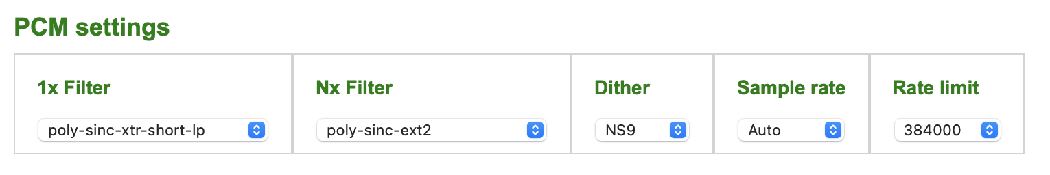

Hi, which filter for PCM would you sign as most spatial, airy or with most separated instruments? Thanks
My settings are this:
