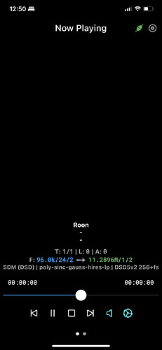

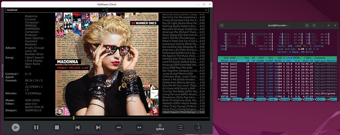

Too bad Roon still displays “filter” incorrectly for DSD sources…
It should be saying “XFi” as rate converter there. If you compare to what HQPlayer Client says.
Surprisingly low load figures still, and temps are not bad at all either!

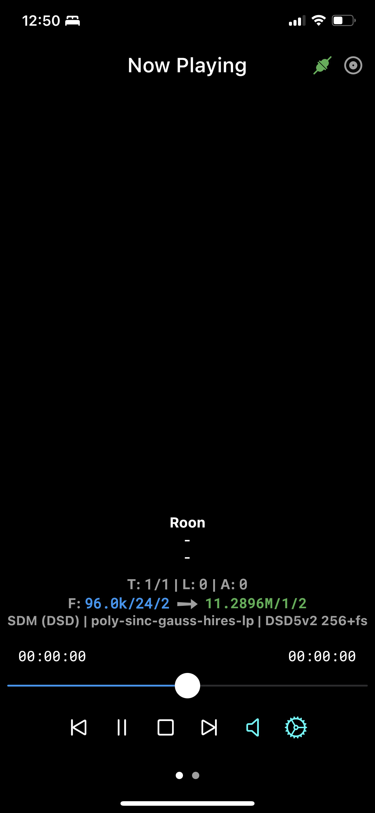

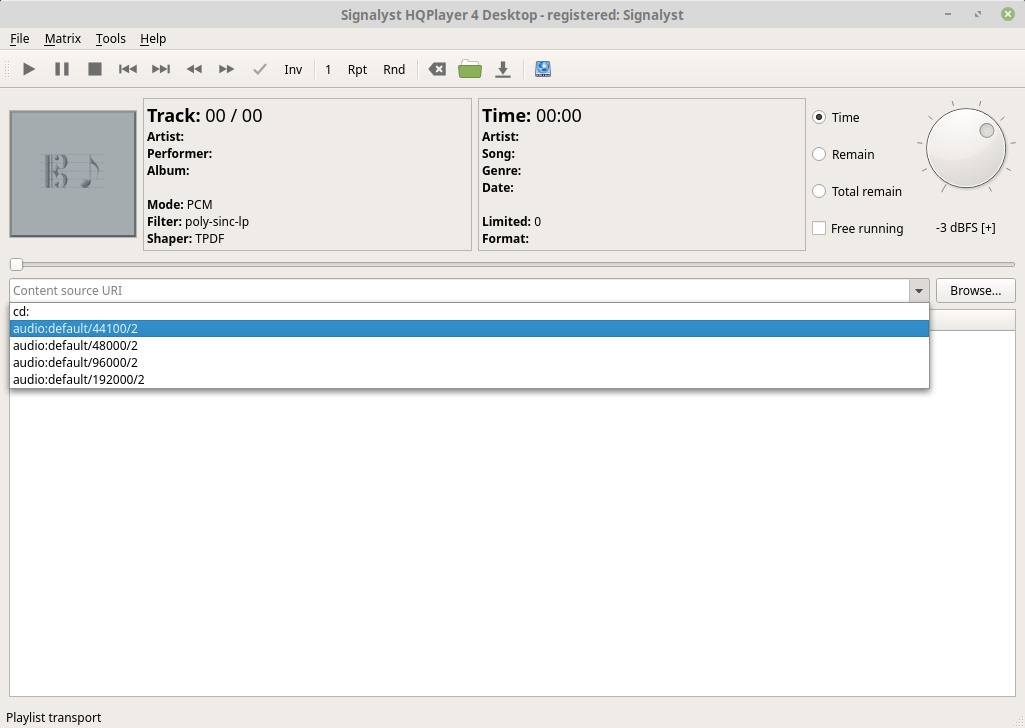

One question the on navigation bar is an “inverting attenuator”?
I’m trying to understand the basics of digital audio, and there’s lots of technical jargon. My question is what’s the function on using the inverting attenuators on HQPlayer.
Many thanks
One question the
That is convolution engine on/off switch.
Next to it, there’s the phase invert, single track repeat, all track repeat and random playback.
