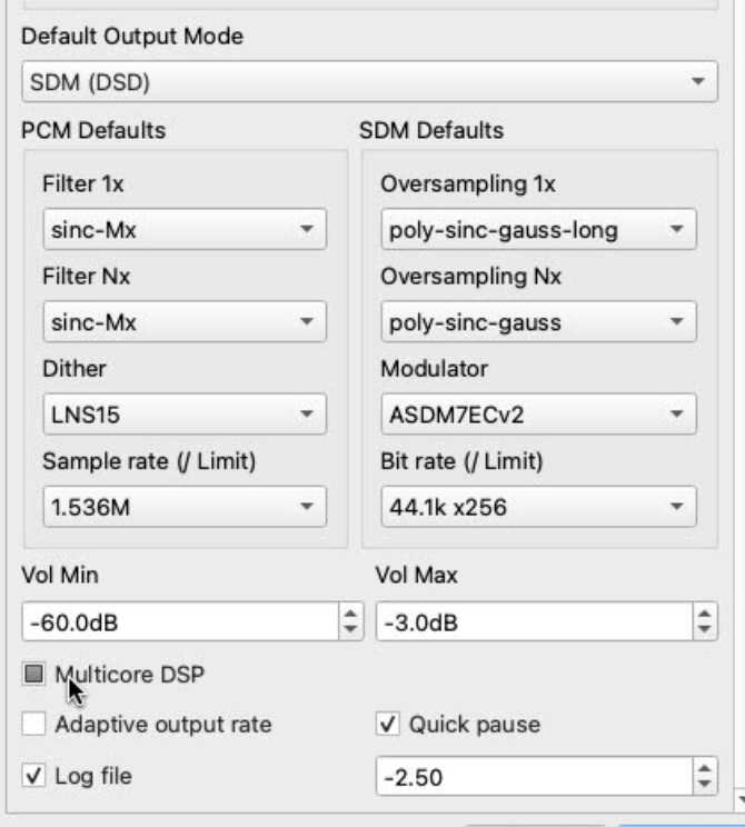

Can you share screenshots of all your HQP settings when it is failing
And can you try my other suggestions above

In these cases, modulator has constant load depending on output rate. Filter load varies based on filter and source rate.
For hires content you don’t need very steep filters. So you could set “1x” filter to poly-sinc-gauss-long and “Nx” filter to poly-sinc-gauss. And be happy.
Take a filter that can process 192k → DSD256.
Tried this earlier today but confirmed once more, Nx = poly-sinc-short-lp-2s is slightly better on CPU load for a 96 kHz file upsampled to DSD256 using the v2 EC modulator but it still produces skipping every 10 seconds or so. I think the v2 EC modulators are just outside the range of what an M1 Mac Mini can handle
Well, the 4 cores doing modulation are running at 95% + on the M1 with ASDM7ECv2 and DSD256. So every increase in load, be it 48x256 instead of 44.1x256, or a slightly harder filter, or higher source rate, might push a thread past it’s threshold. There is so little margin at play here.
