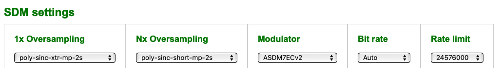

Currently trying this out. Sounding good too:
