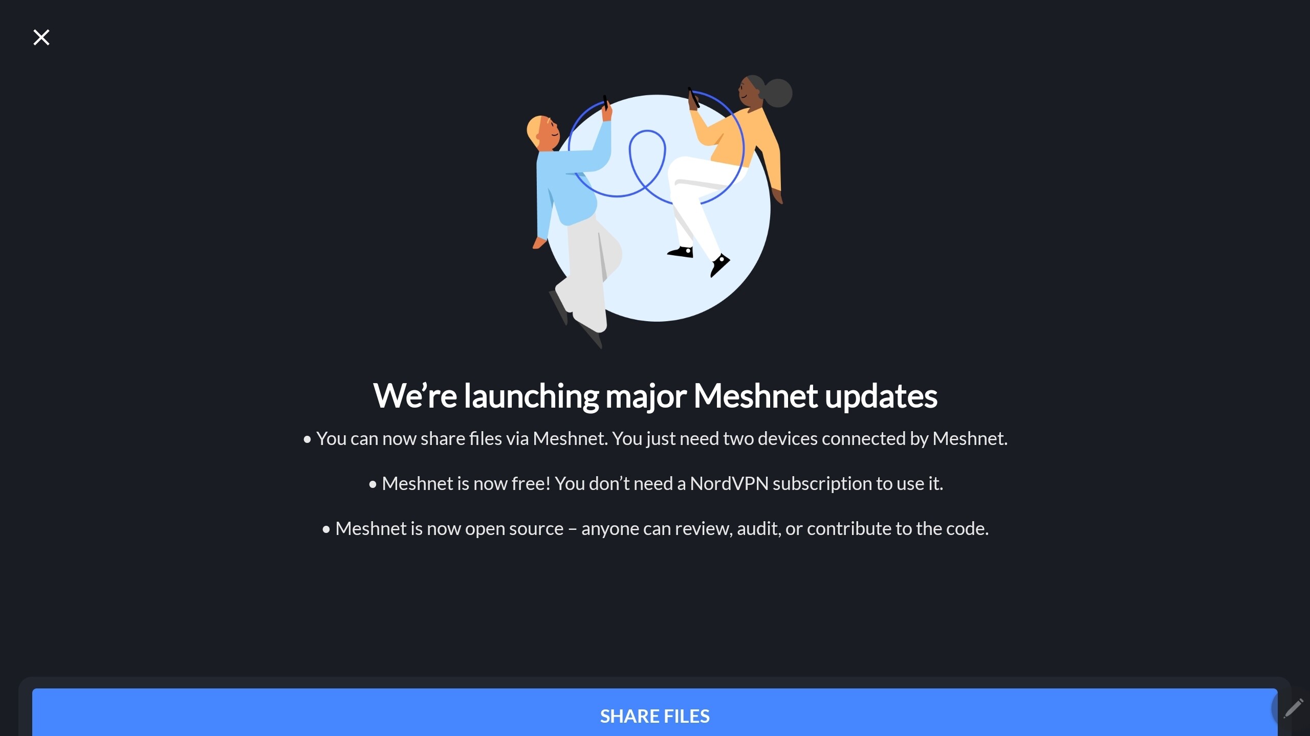

Try NordVPN. One of the features in the service is called Meshnet, where you create a mesh of related devices that connect to each other over an encrypted connection. The NordVPN service itself is paid, but I recently received a message in the client that the Meshnet feature is now free and does not require a subscription.
