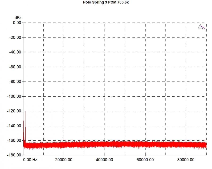

Here’s a DAC playing a very low level -120dB 1khz sine 24 bit input:
Now here’s the same but with the HQPlayer LNS15 15th order noise shaper configured to the linear range of the DAC:
Performance for low level signals is demonstrably improved through use of HQPlayer.
