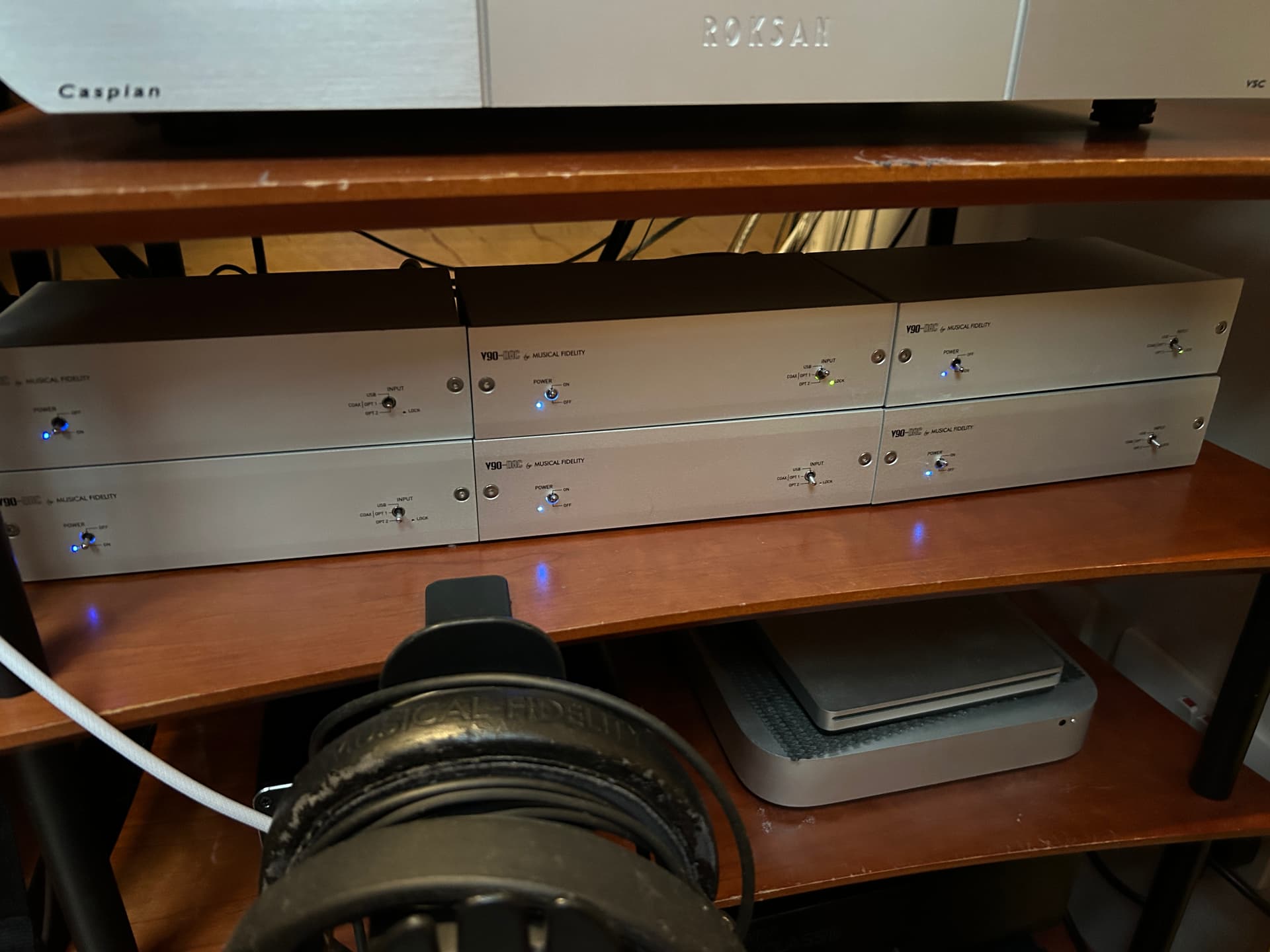

In my house I have multiple raspberry Pis, and multiple DACs providing those endpoints.
These are some of the DACs.

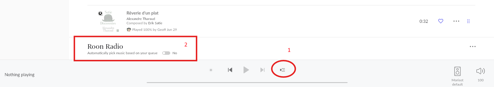

The reason that tracks keep playing is because the Zone that you have selected to play to has the Roon Radio switch turned on.

It seems something else is happening. I disabled the switch you suggested, however when I switch the speaker set - playing in my office and then switch to master bedroom - the music continues to play in my office, does not start playing in the master bedroom and the Roon Server shows nothing is playing and there is a loss of function of the controls. The only way to get the playback to stop is by shutting down the server.

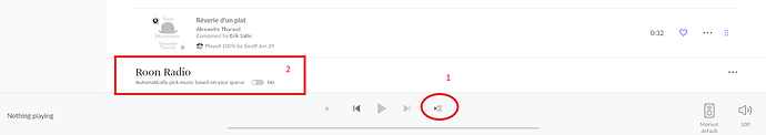

No - the switch is at the bottom on the Zone Queue screen.
To open the Zone queue, click the icon shown as “1” in the Play bar - that opens the Queue screen, and the switch is at the bottom of the screen marked as “2” here.
Please note that there is no “global” switch for Roon Radio - each Zone (and its queue) has its own switch.
