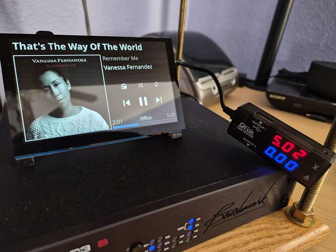

Couldn’t you use one of the USB status displays. They’re fairly common and pretty cheap. Amazon has a bunch. As a test I plugged one into my Ropieee ruuning RPi’s. Wouldn’t this work to tell you if the USB port was disabled or not?
