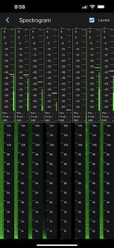

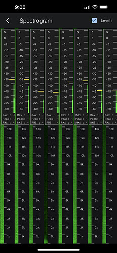

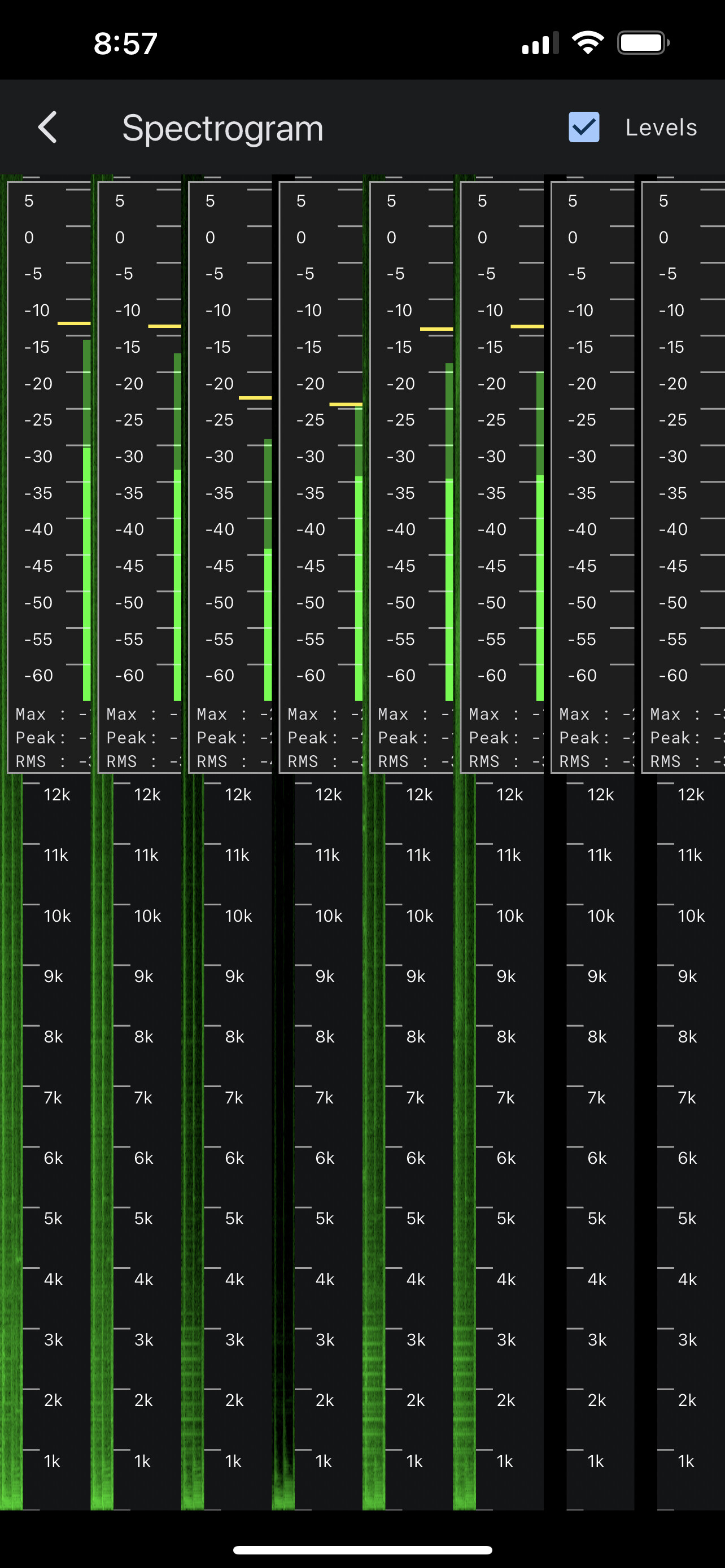

I think that is correct. I’ve attracted a spectrogram of Money from Pink Floyd in three formats: DSD5.1 with the swap in place; DSD5.1 without the swap in place and FLAC Dolby Atmos 5.1.2 without the swap in place. The full 7.1 channels play out only for the Dolby Atmos mix.
So if you are trying to get the 5.1 material to spread out over 7.1 channels, I think it’s a feature request and not a bug. JCR
