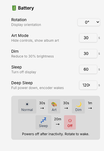

Battery Life - What are other people getting ?. The battery on mine seems to go flat very quickly
As an experiment I charged it up and left it switched on in the evening while watching TV. I turned the dial ring about 4 times during the evening, just to wake it up. After 4.5 hours the battery was flat
Approximately the same here. I use it mostly plugged in. If not recharge immediately after use.
On the bright side: the knob recharges fast.
Exactly my experience. Mine goes flat after 3-4h.

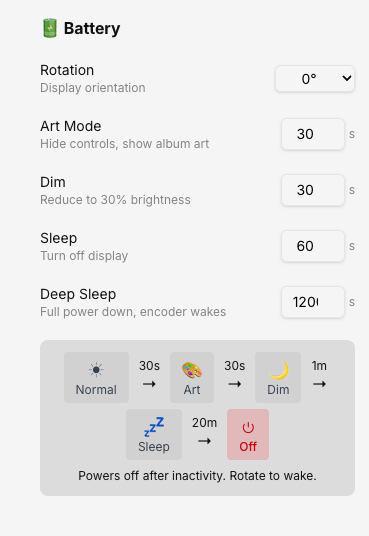

Are you both using Deep Sleep?
That should last a lot longer as it turns off everything other treating the actuator as an "onā€ signal to wake it.
Thanks you both for your reply. I was thinking mine was faulty and would have to go back !
Hi @Muness, That looks interesting. So where do I find the settings ?
……Ok, found it. That’s the settings I have.
I’ll test the two I have to see how long they go with that setting again.
So haw long did they go for?
