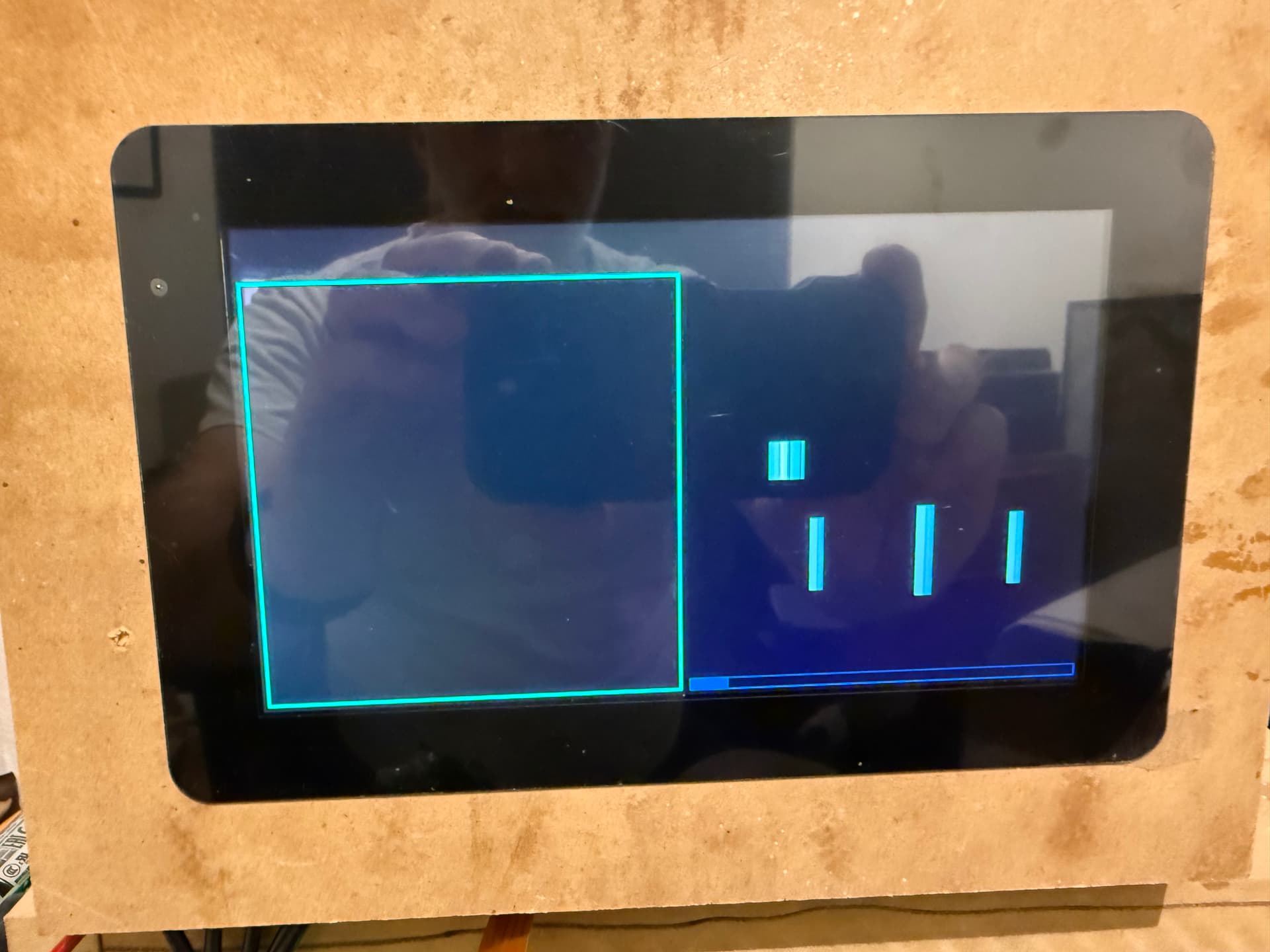

It’s been a very busy week but I’ve finally had a chance to dig into this. I found that the issues with the pi4 were related to the cable. The original cable was fine, but the longer ones I was using didn’t work at all. With the pi5, I was able to get it to initialize on the Display1 connector but not the Display0 which seems strange. However, I’m not getting the correct display and I’ve attached the photo. I seem to recall a similar issue with another user, but I can’t seem to find that thread right now.
On the Pi5 you need to use Display0.
So please put it back on Display1, make sure you configure again (by changing something in a menu, doesn’t matter what) and after the configure/reboot step send me feedback.
