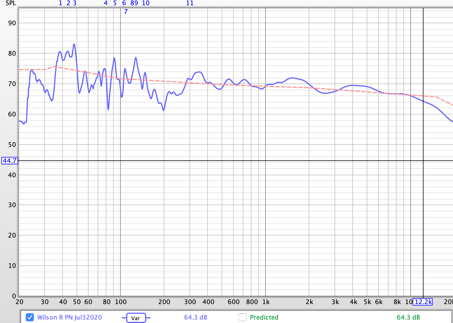

A good first step is to turn on “Var smoothing” filtering in EQ, it will make it easier to identify problem areas as well as help REW with a good correction. Can you show the L and R measurements with var smoothing turned on? (a good range is 50-100dB and 20Hz - 20khz which can be set with the button with 4 arrows up to the right in EQ window)
Hi Magnus, I had 1/48 smoothing. With Var smoothing 50 - 100 Hz range:
and full range (i cannot hear beyond 12 kHz so a bit academic :-))
Target level looks good, I would correct 20 - 700Hz since both channels are on target there and it looks ok afterwards. The problem is that REW might try to correct to much (the small peaks and dips) so maybe disable some filters, which you do by opening the EQ filters window and un-check filters. I suggest to try a conservative “only fix the worst” kind of correction in this case, so try with only 5 filters enabled and experiment.
You usually don’t want a totally flat curve, but a correction that fixes with “broad strokes” so that the overall level is ok. You can see my correction which I posted May 26 as an example. This is one of the things I have learnt since I wrote the guide.
Hi Markus, this is also what i have somehow “sensed” by trying this method in the past. s there a way to restrict the Q’s or restrict the gains in REW? I understand “flatness curve” acts as a minimum deviation threshold but I have not seen “max deviation allowed” type of settings? Is that the reason you revert to manual (and yes, I have seen the relevant post of yours).
I have also noticed that REW cannot correct the major dips (especially the R channel ones). I understand this should not be attempted for null points but I cannot tell if my dips are due to null points or not (have not done the excess phase analysis to detect them)
Gains can be restricted but thats not the biggest problem, steepness (high Q) is. But try auto-correct with only a few filters available and then you can see the details in the EQ filters window. Its typically the narrow corrections that requires high Q so with to few filters available REW will only correct the bigger problems.
Or experiment and do it manually, Q=5 filters should work pretty good in your case except for a less narrow filter (q=2.5 maybe) to lower 150Hz and surrounding in first channel, and similar Q in second channel to raise 200Hz with surrounding. No need to touch anything above 300Hz. But I think you can get good results by lowering available filters and let REW do it.

I never experimented with “modal” filtertype in REW so not sure how that works, and with var-smoothing which does very little at lower frequencies its hard to see because of all the small dips and peaks. Maybe you should use 1/12 or even psycho acoustics.
Try this:
  • Set smoothing to 1/12
  • Disable all but 5 filters in EQ filter window
  • Let REW do auto-correct betweem 20 and 700Hz
    I think that should give a conservative but good result
And yes, I know I suggested var-smoothing earlier but in your case its probably not optimal :slight_smile:
