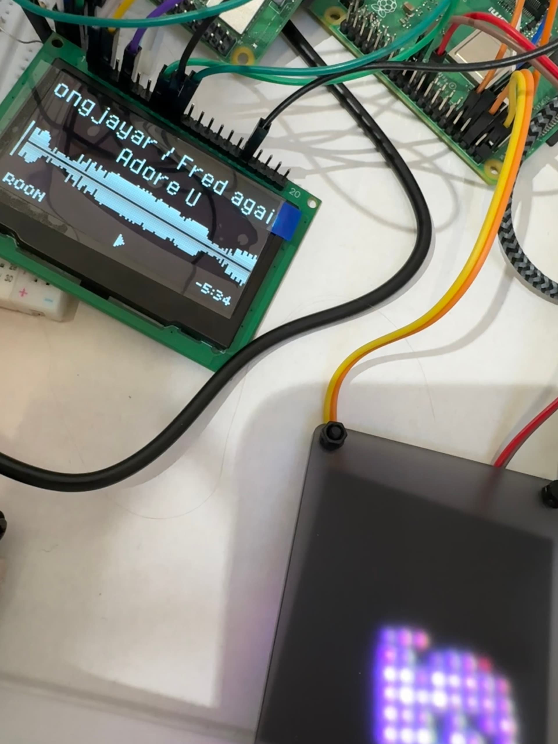

So I have this working :slight_smile:
Now playing metadata for Roon, PlexAmp and Last.fm (as a fallback).
I even managed to reverse engineer waveform data from Roon and Plexamp. The public Roon API doesn’t expose waveform data, so this took some spelunking.
Using the waveform data to show it as a progress bar, but also to drive a small 8x8 LED music visualization.
That might be interesting for RoPieee to show on the display…
I’d be happy to share the code with you, although based on what I’ve read from you, you might not approve of my methods :rofl:
Waveform data is not part of the public API, but it IS visible on Roon’s own display endpoint. So first I tried pretending to be a display, but that went nowhere because the API the display talks to only accepts requests coming from the same origin. So what I do now is load up a lightweight headless Chromium instance with Playwright, and listen in on the websocket. So my Roon monitor app shows up as a connected display in Roon. And then you have access to all the goodies; metadata, waveform data, lyrics, etc.
Again, happy to share the code, but my assumption is running a headless chromium in Ropieee just to get waveform/lyrics data might be a bit extreme.

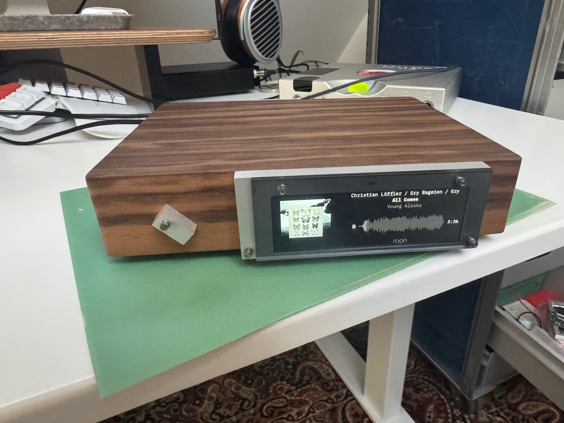

To close this off: I have just finished my custom ropieee display. This box bundles a ropieee instance with a separate display system. It currently works with Roon, Plexamp and last.fm (which I use as a fallback to monitoring airplay, by letting Apple Music scrobble plays). The monitors are all separate mini applications with a shared data store (memcached). So I hope at some point I’ll be able to add a service for AirPlay metadata by reading directly from ropieee.
The case was milled out of a solid block of walnut. The little aluminum block on the front is a play/pause button. The touch sensor has an issue with phantom touches at the moment, that’s why in the video the track randomly pauses/plays. I still need to fix that :slight_smile:
Video: Link
