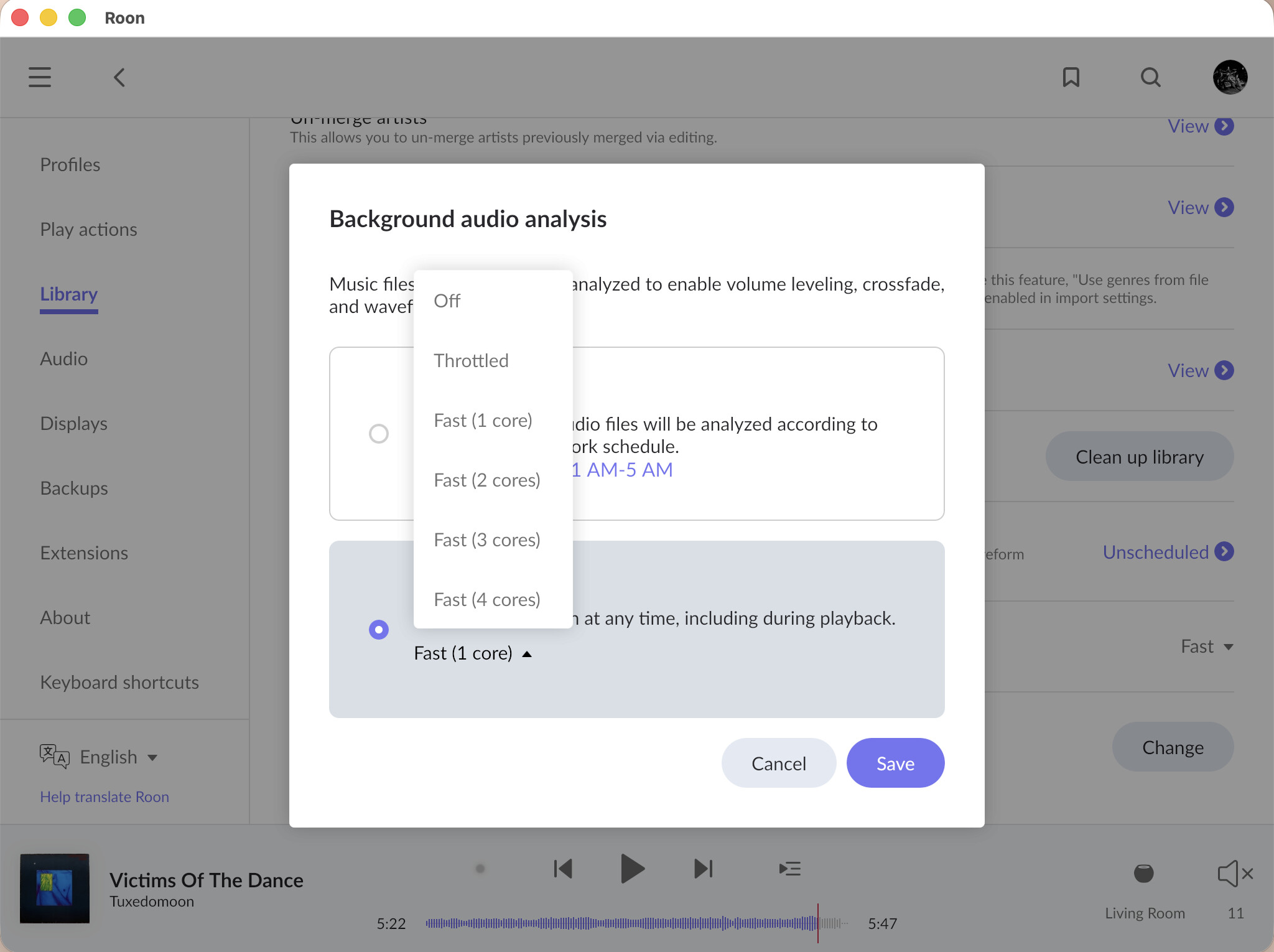

  2. Why are there two choices for unscheduled / disabled? Maybe I’m missing something, but these controls should be consolidated.
    a. You can select Scheduled and then set Disable schedule (run continuously) with no options to select how many cores you want to use.
    OR
    b. You can select Unscheduled and choose how many cores to use as before.

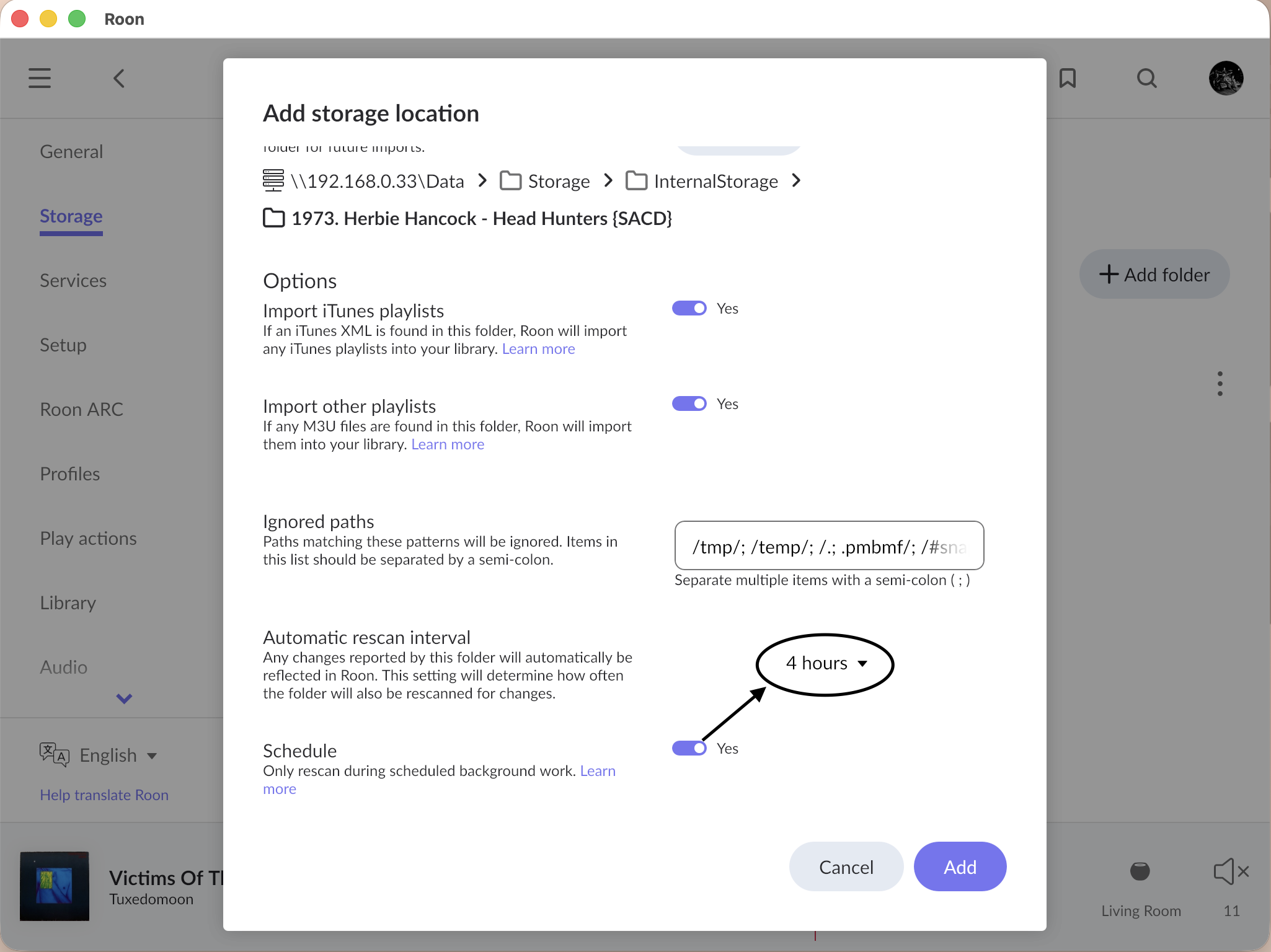

  3. For rescanning of storage locations, the layout of the ‘Automatic rescan interval’ and the ‘Schedule’ toggle is a bit confusing. If ‘Schedule’ is toggled on, does that mean the automatic rescan interval is ignored and the rescan is kicked off immediately? If the rescan isn’t started immediately, then what happens when the rescan interval is 8 hours, but my scheduled analysis / background work window is only one hour?

For #3, there is a dropdown which allows to pick the Audio Analysis speed setting:

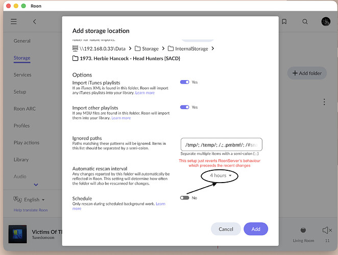

For #5, background analysis scheduling in this case does not have any influence on the scanning folder settings. For the network storage location, if on schedule, it will be scanned as many times inside of the schedule as it permits. For example, if your network folder location is set up to perform a rescan every 2 hours, and the background work is scheduled to run for 6 hours, then your network storage location will be rescanned 3 time during the background schedule:
On the other hand, if you set the network storage to “Unscheduled”, then it will be automatically rescanned every X hours ignoring the schedule.
