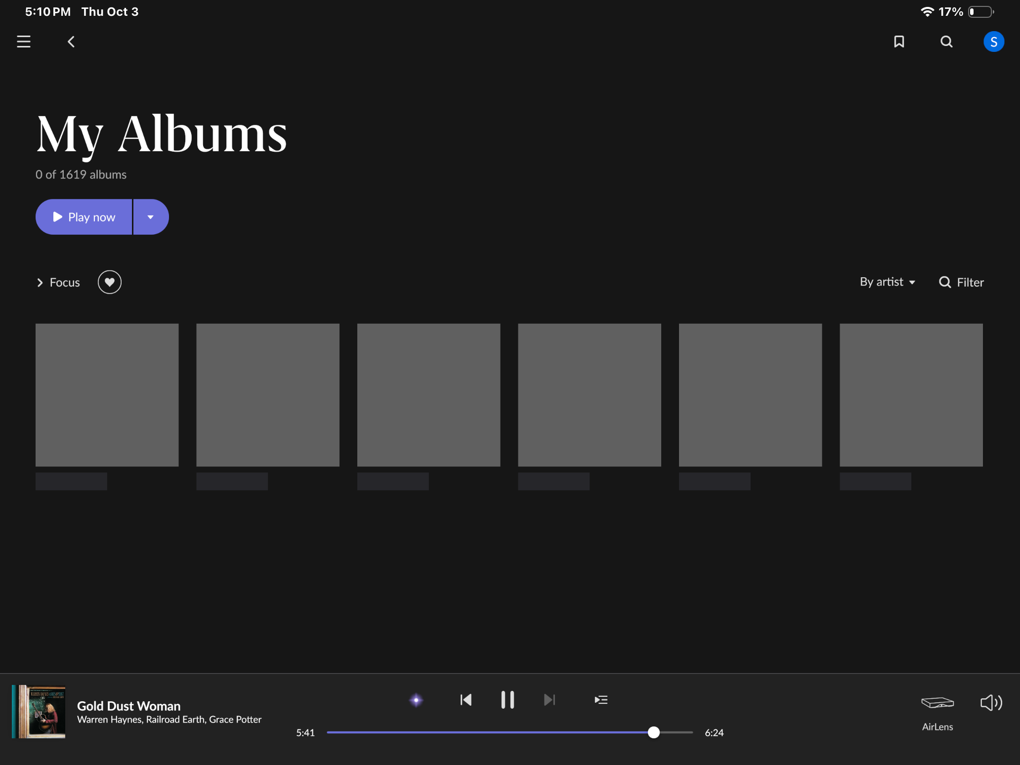

As it turned out, I just swapped the original 4GB RAM module in my Nucleus for the recommended twin 8GB modules and it couldn’t have been easier.
The hardest part was unplugging everything from the back of the Nucleus and then plugging them back in again.
I was getting these screens all the time:
Screenshot 2024-10-08 at 1.57.38 PM
Now everything is loading lightning fast (knock wood). :crossed_fingers: :sweat_smile:
