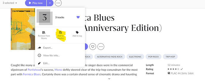

Bring up the album from which you want to add tracks:
Right-click on a track you want to add. Note that the play buttons at the left of the tracks turn to selection circles, and the number of items selected shows up at the top of the screen above the album art:
Select more tracks. You can left-click or right-click; once you’re in selection mode it doesn’t matter. Here tracks 1, 4, and 6 are selected:
Click the three-dots icon next to the bit at the top of the screen that shows how many tracks are selected, not the one next to the album art:
Select “Add to Playlist” from that popup and only your selected tracks will be added:
