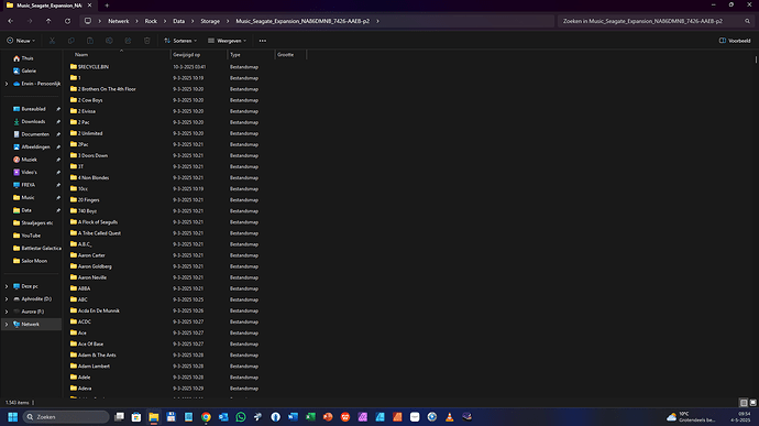

My Roon server shows up on my home network. I fire up my Windows PC and copy the files over the network. Done.
Do some searching the knowledge base or forums for ‘network share’.
You can create network shares in Windows. Then you can just use the Explorer to copy the music files between your computers. No need to use USB sticks to do the cumbersome manual work yourself :slight_smile:
My Roon Rock music storage accessed through Windows Explorer on my main computer. It is the same thing when using a Windows OS instead of Roon ROCK. :slight_smile: I can just drag and drop files between both my computers.
